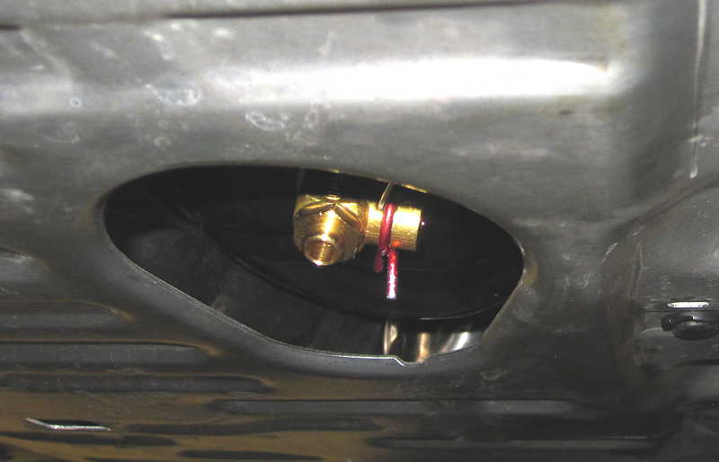

I replaced the original oil plug with the Fumoto F108S Oil Valve using the blue rubbery gasket that came with the valve. This version of the Fumoto valve has a short nipple for connecting a hose for draining. The installation was quite painless.
Fumoto F108S Oil Valve Installed on my Scion FR-S (with safety clip):
Attachment 71234
Attachment 71235

StevenEngage 07-15-2012 07:43 PM
I have never in my life heard of that oil drain valve....that is F***ING amazing. I will be doing some research on those and probably putting them on all my vehicles.

I also ordered the Fumoto drain valve - how's that working for you?
For the original oil plug, I used a box end wrench with a dead blow hammer to get it started. I just thought it was because I was weak! Anyway this method worked with just a few taps from the hammer on the end of the wrench. If I were re-using the plug I would not have put it that tight. Perhaps the same paint-glue stuff that sticks the crush washer on also stuck the plug to the oil pan. Maybe also this is done so that the dealer can see if the oil plug has been removed - this may be important for warranties in some countries.
The Fumoto drain valve is working great so far (1 week in) - no leaks. I think oil changes will be completely different with this valve. Note that I needed to use a pliers to get the safety clip in place. My fingers are just not strong enough to squeeze it open against the spring tension right now.
