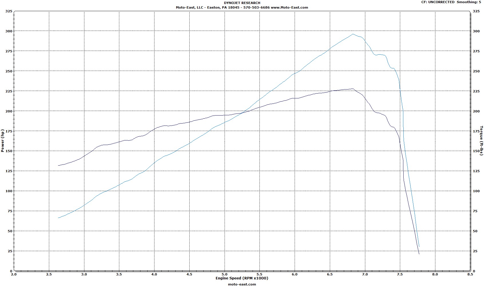

Here's what we got on e85 today in 4th on the c30-94. This is UNCORRECTED with 90% humidity and 80's temp. About 4-5% correction would bring it inline with STD, another 5 hp or so for being in 4th vs 5th. (5th is 1:1)
We ran out of fuel on e85 and stock fueling. At around 7k you can see it drop off where it had enough. Same stuff we've been seeing on datalogs. Can't wait to see it again when it gets the injectors/pump in the next week or two. Smooth, no?

Beautiful!
