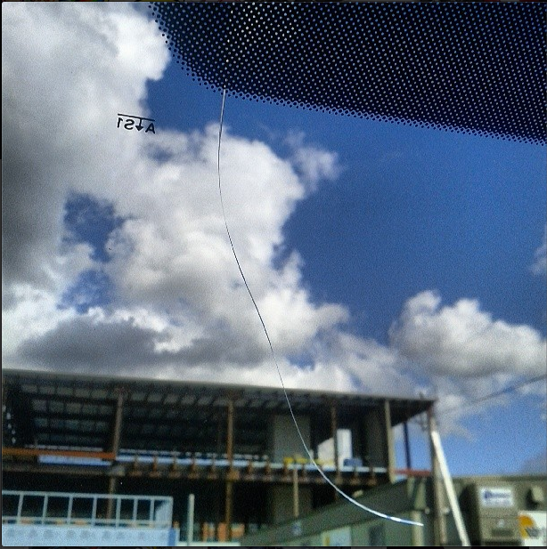

I'm here to join the club. Came out of work today to see this. Since my comprehensive deductible is $1,000 it looks like I'm out of some money.
