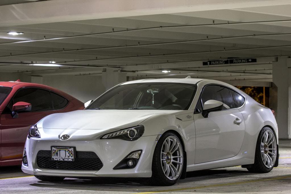

another pic as requested.

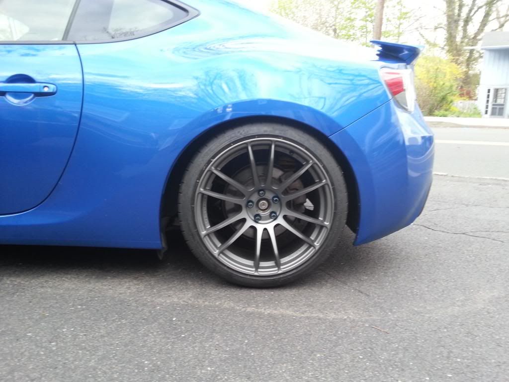

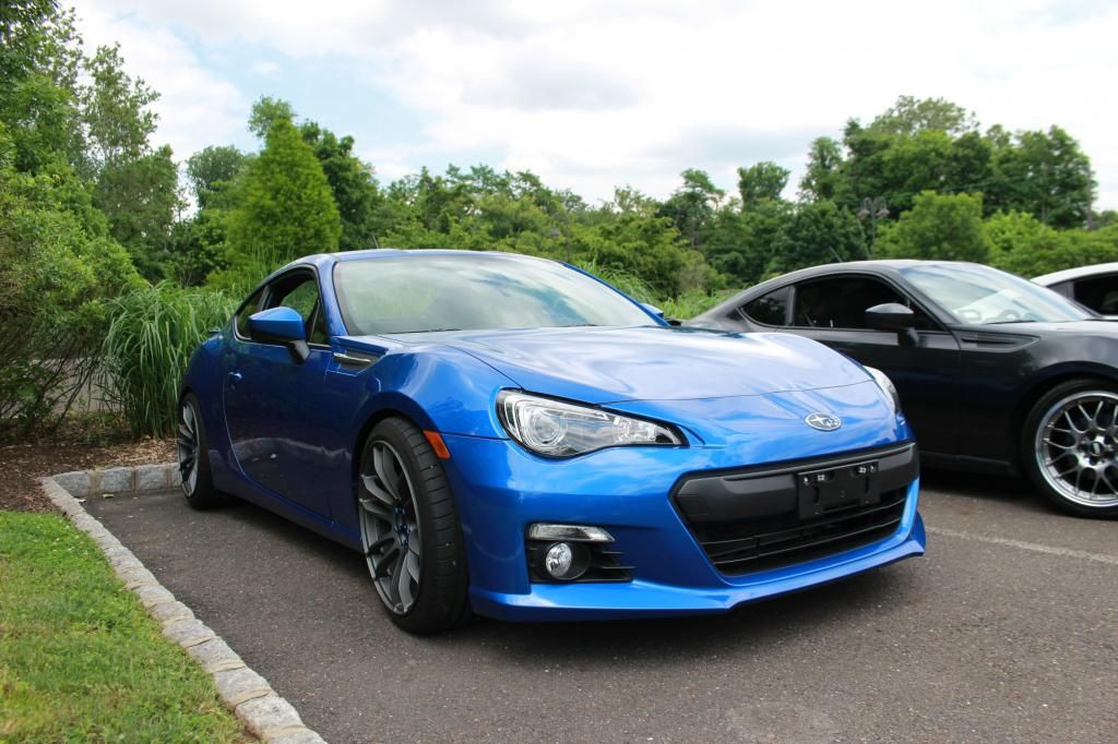

Ask and ye shall receive.
My car: 18x9.5+40 w/ 245/35/18's square

how much did you lower it? also how bad is the front poking out? trying to get the same set up but with 265/35/18

I don't know exactly how much I lowered it. The majority of those pictures were taken right after the coilovers were installed, but I'd say it has probably settled to about a 1-1.25"drop. The front pokes a little, maybe 1/4"with the natural camber that came from lowering it. It bugs me enough that I just bought camber bolts to help make it a little less noticeable, but I haven't had a chance to install yet.
That setup should work if you stay with a mild drop. I had ordered 255s based on my research but the damn shop messed up the order. 265's will probably need fender rolling to avoid rubbing.
