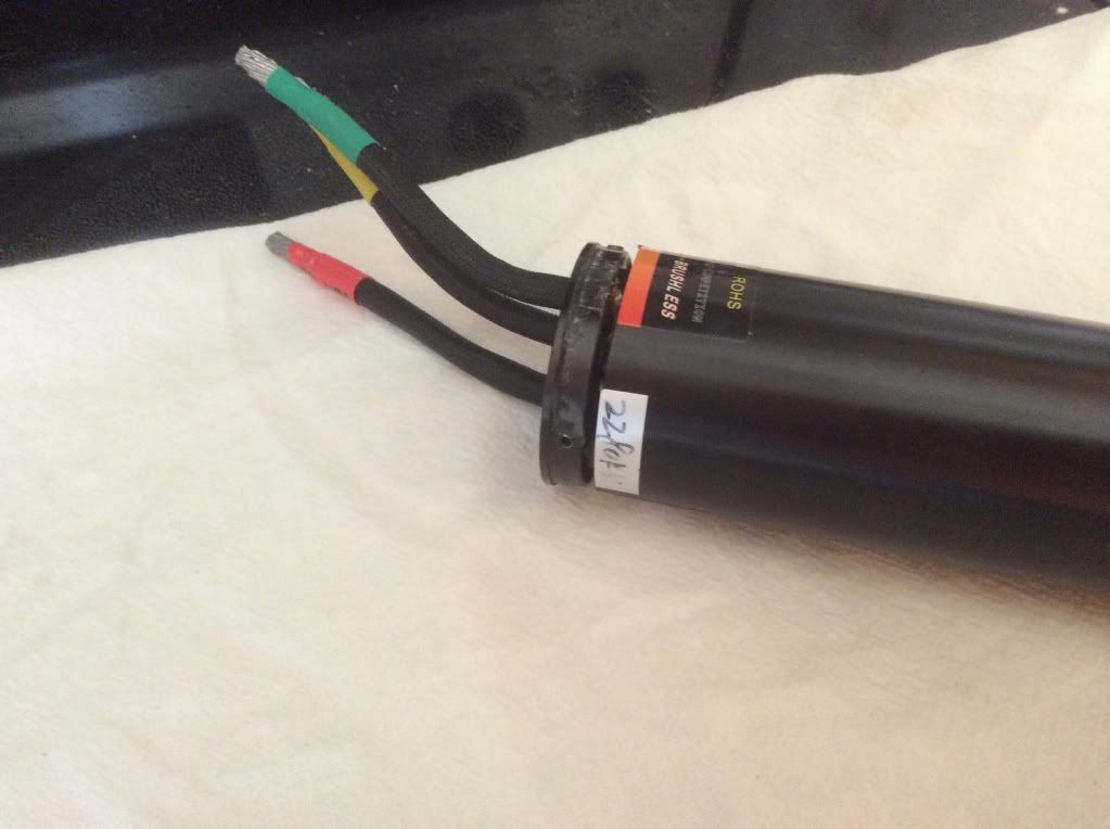

So I received a couple of motors yesterday, and I'm disappointed in both.
1st the SkyRC Beast x513 3Y. So far this motor isn't working well. It seems to have cogging issues and just won't spin up smoothly. I'm not surprised by this it's far from the most powerful motor. I still need to try tweaking the ESC settings. This could be an issue with timing. Or a soft start setting
2nd the TP Power 4070 2280Kv. I'm very disappointed, it was received damaged. Out of the box the end cap had come loose and the motor is pretty much useless. I've contacted them and requested a return for a full refund. I like the specs on their motors, but after seeing this I'm questioning the quality.

That's a bummer. Really disappointed in the TP Power motor. They had good reviews on other forums. Was the box damaged ? Did it ship from US or China ? Did they forget to put the screws that hold the end cap or its just glued ?
Would you want to try the other larger TP motor ?
They were very good in response. The sent me an RMA label and said as soon as they receive it they'll issue a refund.
It was shipped to me from the US, but they are manufactured abroad. They think the damage occurred when it was shipped to them. They seem like a good company and if every thing goes well with the return I'll still consider them as an option.
