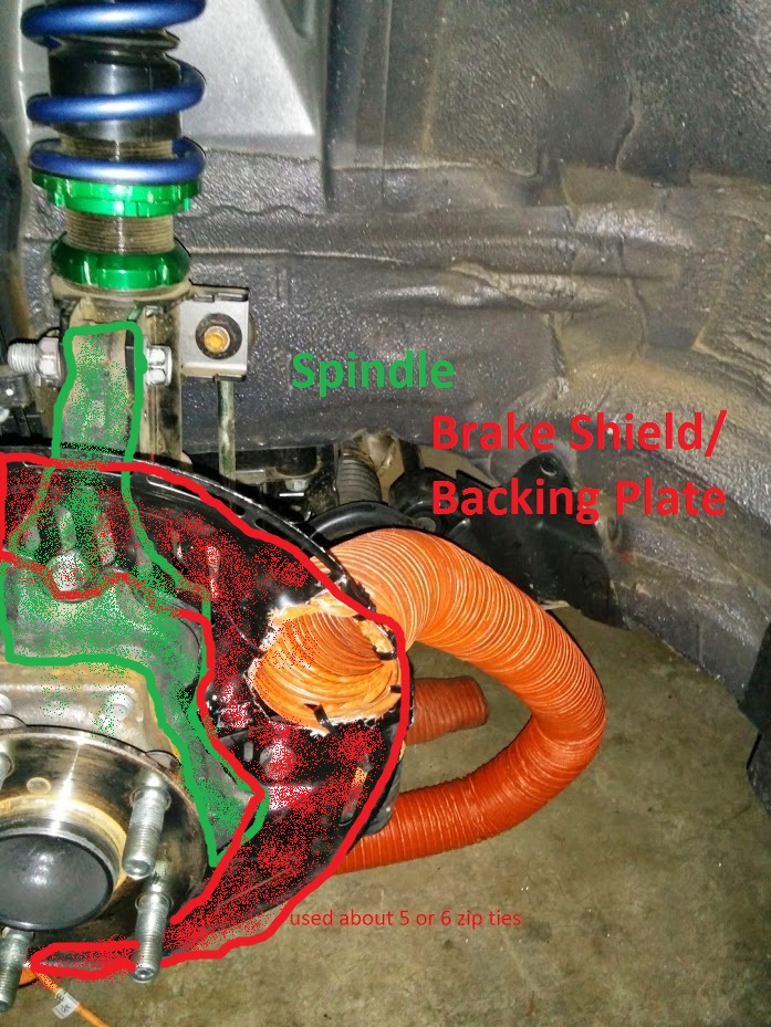

Just for terminology's sake.
What you're calling the spindle is actually the "Brake/Dust Cover" or a "Backing Plate"
Not being a **** here.
Mad Paint skillz, I know.
Thanks for sharing the progress.
Attachment 84781
Sorry for the confusion, and thanks for clarifying and yes I was referring to the brake dust cover/ backing plates.. I updated the wording accordingly
