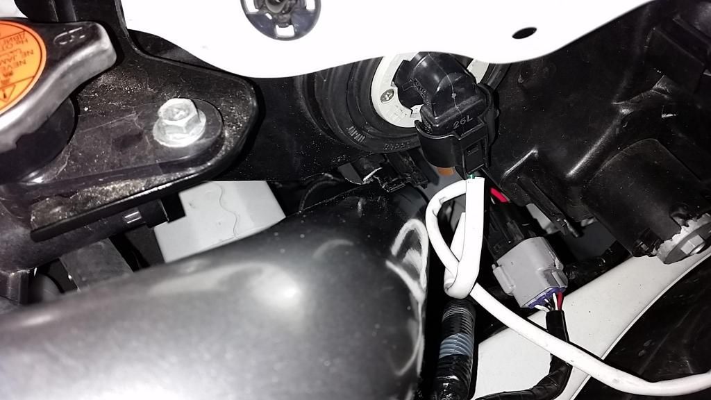

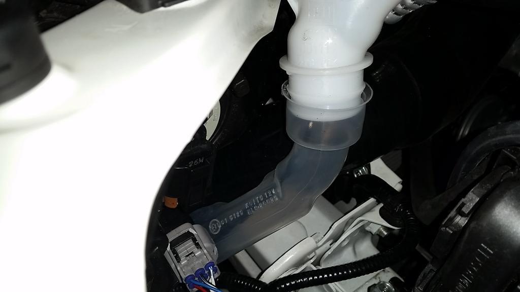

Does anyone else have these issues?
Bumper not fitting because the grill is pressed up against the charge pipe.
Had to remove some of the unused clip on the Passenger side headlight housing:
Moulded charge pipe and washer fluid neck fits too tight. Molded charge pipe is pressed up against the passenger headlight.

Yes everyone with an frs had those issues. @KraftWerks has new updated directions to show you how to fix them.

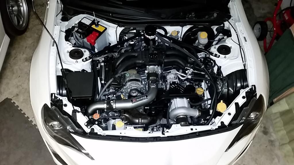

Installed my mishimoto oil cooler with the kraftwerks/skunk2 sandwich plate. Clearance is just close enough.
I was going to put two more brackets on the bottom of the cooler, but I literally burned out my Dewalt drill putting holes in that beam. It's still very secure though.
Next stop is a shop that can cut out my grill and mustache and replace it with a custom grill so I can get some air flow to the oil cooler.
Is that how the hoses were meant to be run? They look like the should of been trimmed down
Otherwise, nice install. I've never seen one mounted there.
Yeah they are definitely long, but that's just what came with the universal mishimoto kit and I wasn't about to try to cut them and shorten them so, oh well I suppose, it'll do for now. Might lower it a smidge to get it a little further from the intake.

The fittings look like standard ferrule fittings. If they didn't come tightened with the kit, you should be (or should have been) able to open them and shorten the hoses as needed with a braided hose cutter.
They're reusable AN hose ends. You can disassemble them, trim the hose, then reattach the fitting. There are lots of tutorials on YouTube, just make sure you take extra care when cutting the hose because some of the steel from the hose can make its way into the threads and ruin the seal. Overall it's not that hard if you take your time

Well perhaps next oil change ill give that a shot. Thanks guys!
