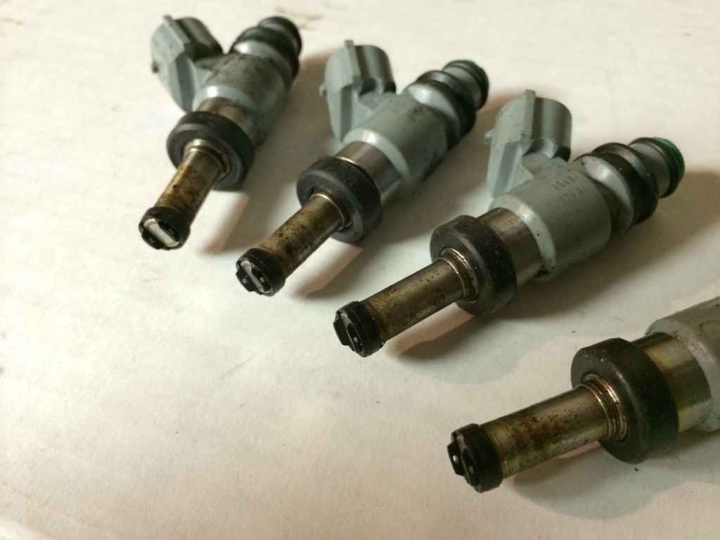

I pulled my port injectors recently after running straight E85 (80%) for about 17,000 miles, with maybe 2 tanks of 91 mixed in there somewhere. Injectors looked fine.. I can post some pics later tonight.

Pics please

Oops.. Forgot about this. Let me take some pics tomorrow

Originally Posted by brianhj View Post
Pics please
Size:  210.4 KBName:  ImageUploadedByTapatalk1406885157.126534.jpg
Size:  198.8 KBName:  ImageUploadedByTapatalk1406885162.976853.jpg

A little off-topic, but I'm curious as to why USDM cars have grey port injectors while the ones in my JDM spec are orange. I wonder what the difference is? You guys also have clip on fuel lines while ours are clamped
