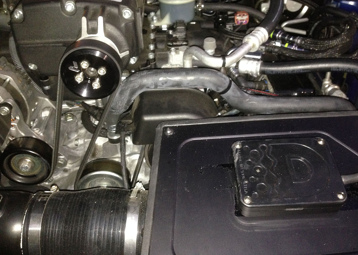

Finally!
48 weeks of waiting. Two weeks of a couple hours here and there. And one marathon session today. Finally, it's together!
And look! A left over part!
In this case, it's a good thing.
You know what's F***ING delicious after working for hours in the sun? Water.
I hope I never get hit in the front left corner. There are so many freakin' hoses and lines there now.
I still have one wire to run then it's just a matter of getting a hook-up from Delicious and I'm in business!
