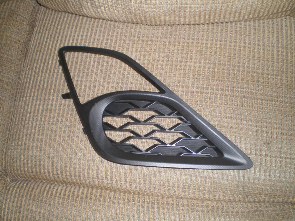

used exacto knife to cut out the vents. I needed a larger blade because the knurling on the handle kept gouging the grille

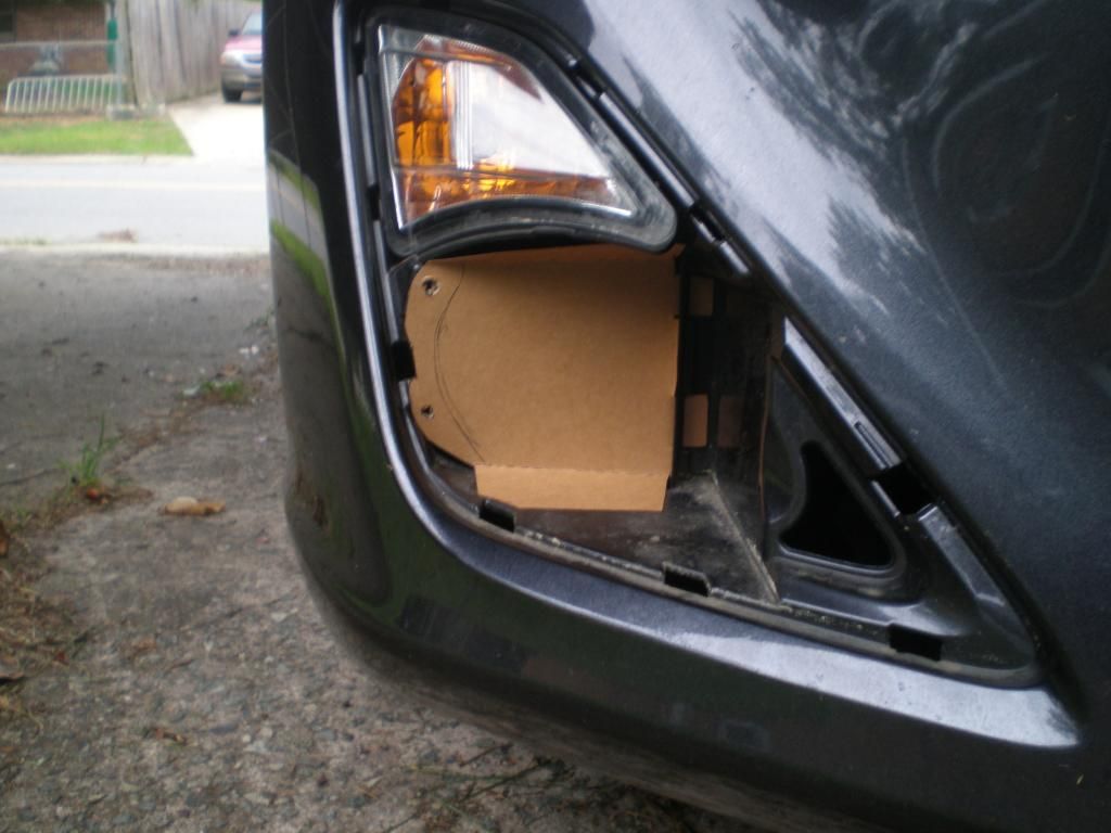

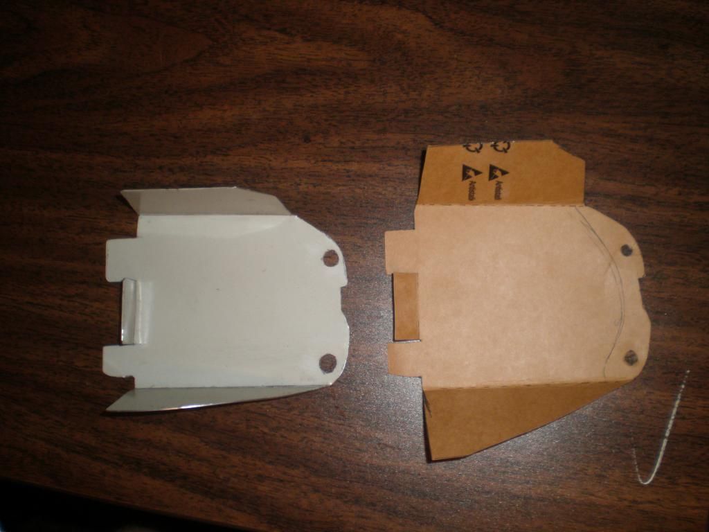

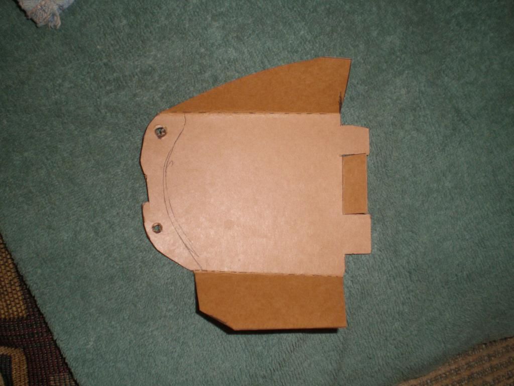

Cut out a template. I later had to modify it some to clear everything. The tabs on the side are too long to fit in with the hose hooked up, and the top sticks out too far and hits the grille

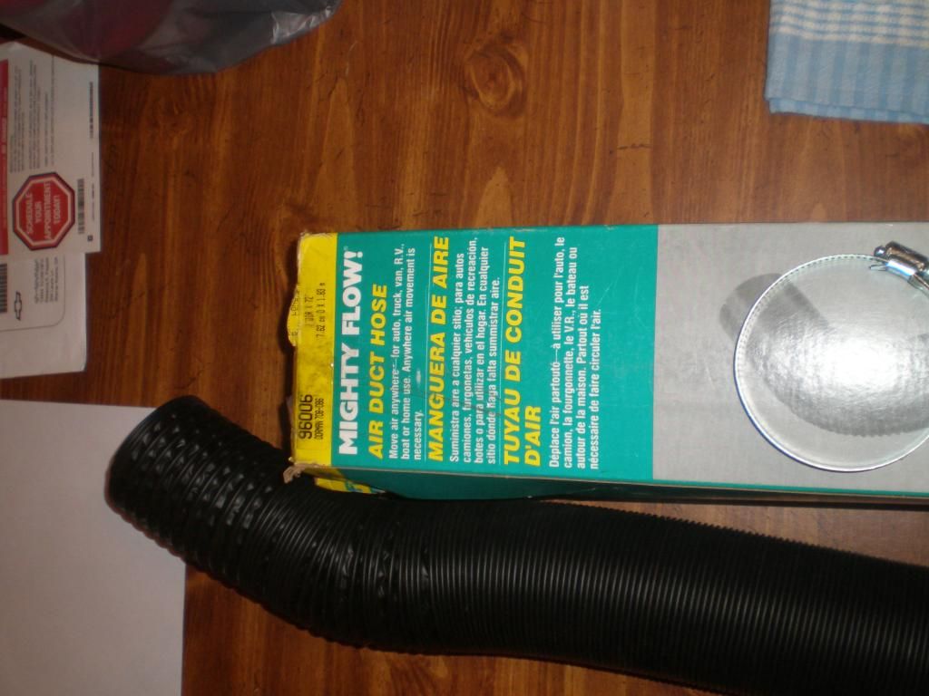

Hose from Advance auto, ~$12
mounting bracket cut out of an old filing cabinet divider I found.

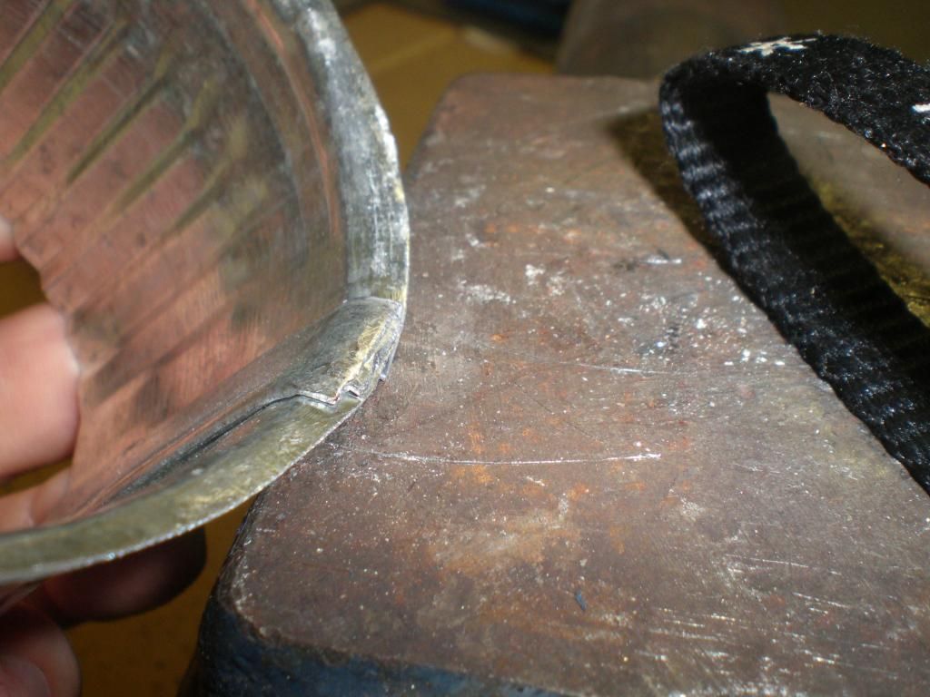

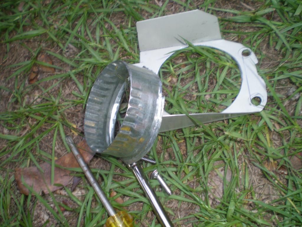

Got a 3'' sheet metal duct from lowes for ~$3. I cut off the end, locked it together then flared the end with a hammer and vise. I had to cut notches out of it to fit between the top and bottom of the bracket.

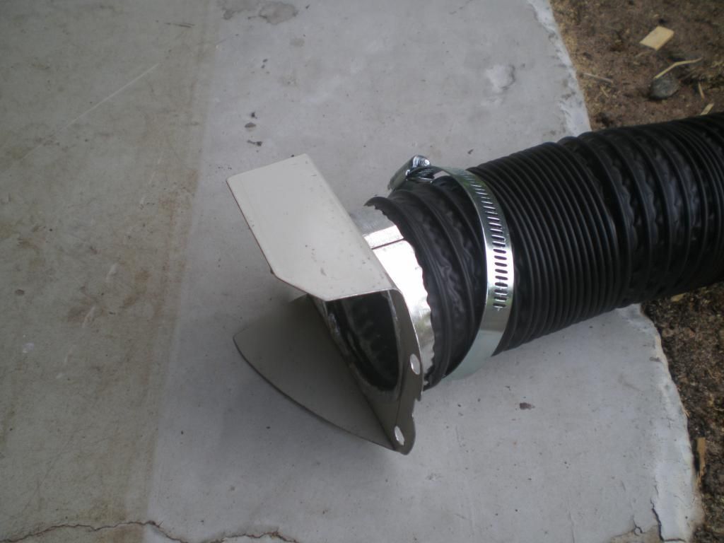

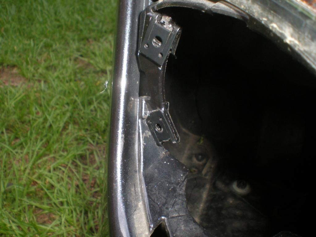

Clips and screws from lowes ~$2. I had to modify the bottom to fit(notice the 45 degree cut, If you can find the proper part number, you will save yourself some headaches by getting the actual Toyota fog light speed nuts
A mock up of assembly. I had to take it back apart and cut more off the 3'' flange, it was too wide to allow the hose to bend so that the bracket could slide into place

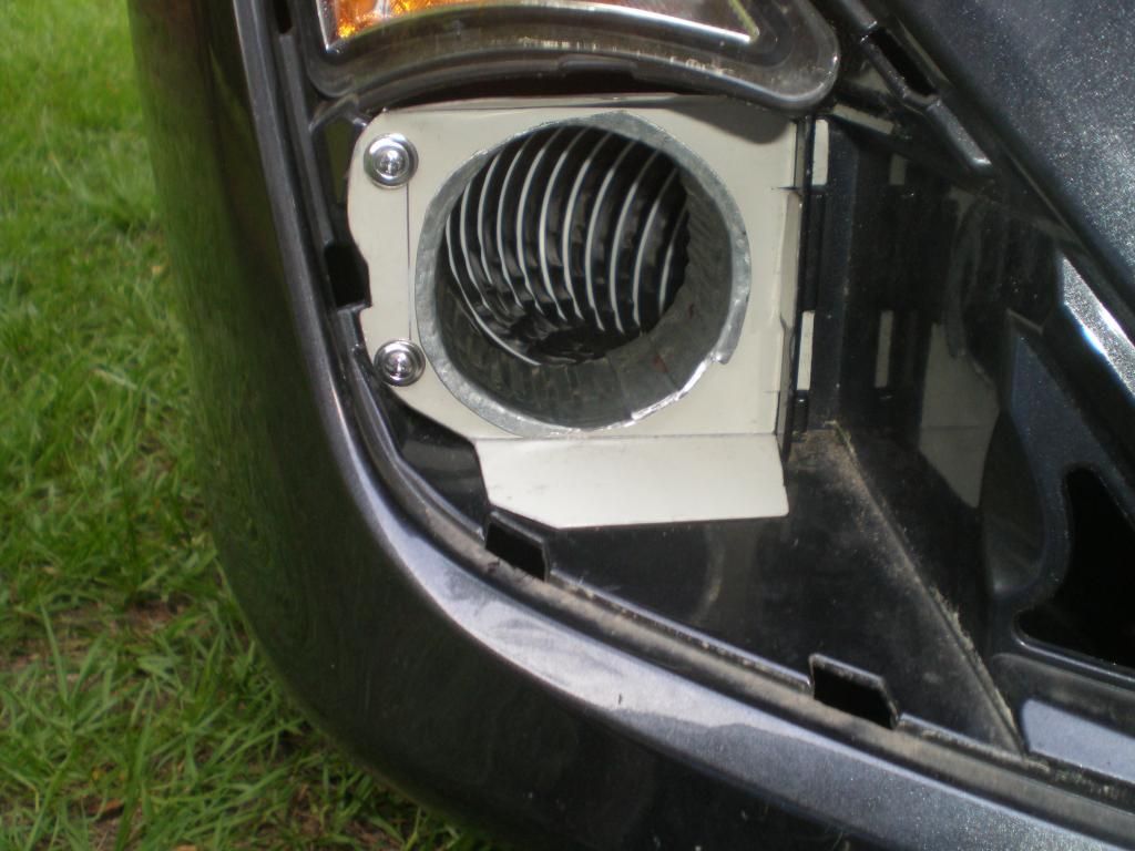

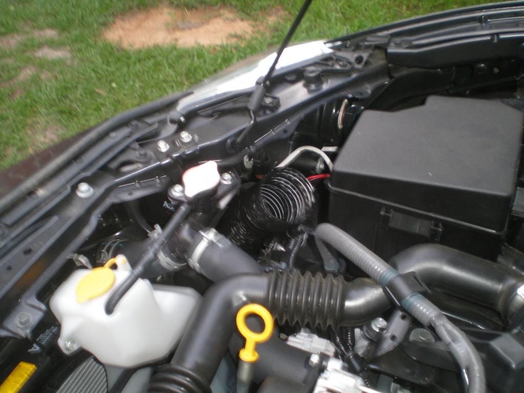

Mounted up.. I may have to go back and paint everything black
I unclipped the headlight connector from the body mount and pushed it to the side to make room for the hose. I don't have a money shot pic... At least not until Early Aug (crosses fingers), hopefully I will be in the July batch.

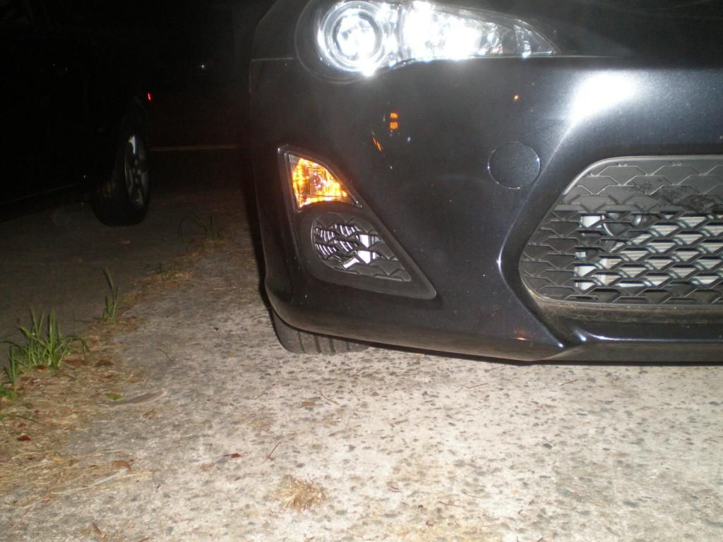

And everything back in place.
total cost ~$25

Looks great. But maybe paint the silver metal.

Thanks, I added text to the pics saying the same thing on the last one. I have been driving around for about a month with my grille taken out. I was kinda of eager to have everything put back together. (I didn't want to break the grille taking it out/putting it back in every time I came up with a new idea)

REALLY nice job!
