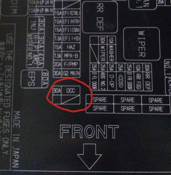

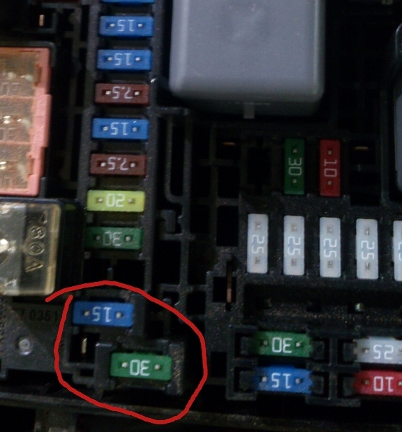

Problem solved ! The flashing CEL is now gone, here is what I found:
The DCC fuse (30A) was never removed from the "delivery" position during PDI into its original location, instead, there was a (15A) fuse installed, here is the pic:

fuse box cover picture to confirm:
Name:  fuse box cover.jpg
Attachment 80538
It should be like this (pic form internet):
Attachment 80539
Attachment 80540
Good, that'll be 89.95 for the hour diag, I take PayPal. Thank you come again.
