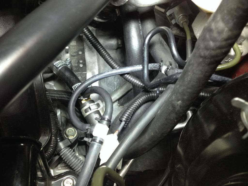

Don't mean to revive a dead thread but the information here is the best I could find regarding the boost gauge installs on the FRS and I'm having some issues with mine. I tapped into the brake boost line between the engine and the check valve for my Defi boost gauge. But when I'm driving I always see -30psi unless I press the brakes. If I press the brakes repeatedly the boost rises, then drops back down to -30psi. Could someone give me a pointer to what I did wrong?
I circled the check valve on the line for clarity.
It looks like the tap from the brake booster line is correct as it's below the check valve. Where's that tube running to?
Thanks for the reply! I know this thread is dead. But it's still the best I've found on the subject.
That vac line only runs about 6 inches from the T to the sensor

Really hard to say because the install looks good.... maybe a bad gauge or sender unit?

Maybe. But it's weird if you watch the video that it gets boost when I press the brake.
I have a mitivac I'm going to hook in to see if it's getting the same readings.
