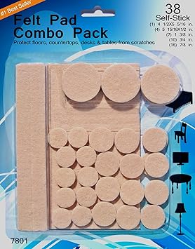

I just cleaned the hard stop with some acetone and used one of these little buttons. Works perfectly and I have 15 extra.
What u use to get the felt to stick?
They're probably self adhesive.
lol... top right corner of the pic.
Seriously though, it works perfectly. Even feels better than the rubber stop.
If u have 15 extra that means you used 23 felt pads?
lolol.... They were really thin.
My wife puts them on everything so we have a junk drawer half filled with opened packages.
Terrible that this OEM rubber stopper is a POS
Nearly anything is better than the OEM rubber stop. It's soft thin rubber that degrades easily over time, and is accelerated by heat.
...for the record, I only type "lol" if I actually lol. Good stuff.
Ultramaroon, great solution using local hardware store supplies. You can dial in the stop height precisely by stacking the discs. I'd be worried about the adhesive degrading over time due to heat, but with so many spares in the pack, you can change them pretty often.
