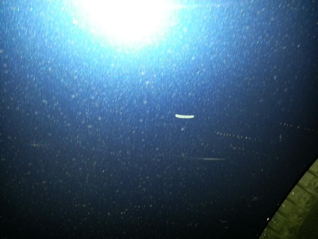

The dealership scratched my car.
So I've got about a half inch scratch in my month old car. It's through the paint. I'll grab a picture of it later. It came back from the dealership after they fixed some hoses they mixed up while doing the recall replacement of my fuel pump. They said I can't prove they scratched it so it sounds like I'm pretty much screwed. Is there anything easy I can do to make it less noticeable?

Hopefully that image loads. The smaller lighter scratch underneath came with it. The dots behind it are just from it being rained on and dirty today.
