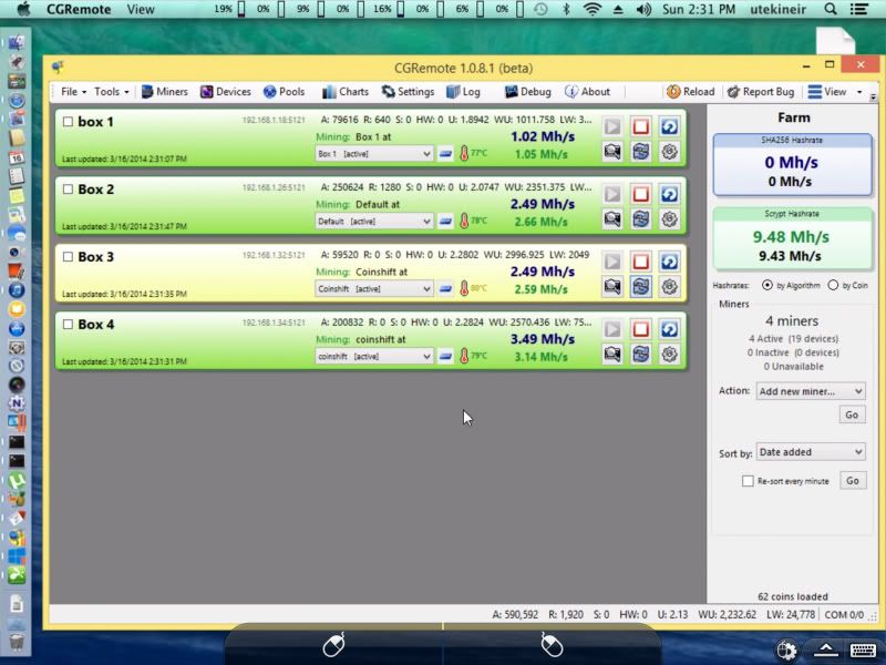

Maxcoin finally dropped enough that I switched off it, the decreases in difficulty had kept it going well enough.
Reconfigured things to coinshift a few hours ago.
Also put on cgremote and started playing with xintensity, next on the list is new thermal paste for all cards, bios modding and tweaking of settings, should be able to squeeze a bit more out. Running it through parallels on home server Mac mini, then splashtop for remote access.
edit: coinshift sucked once i switched over
