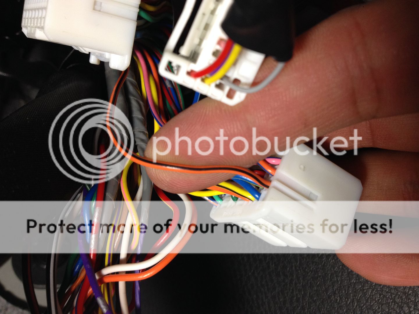

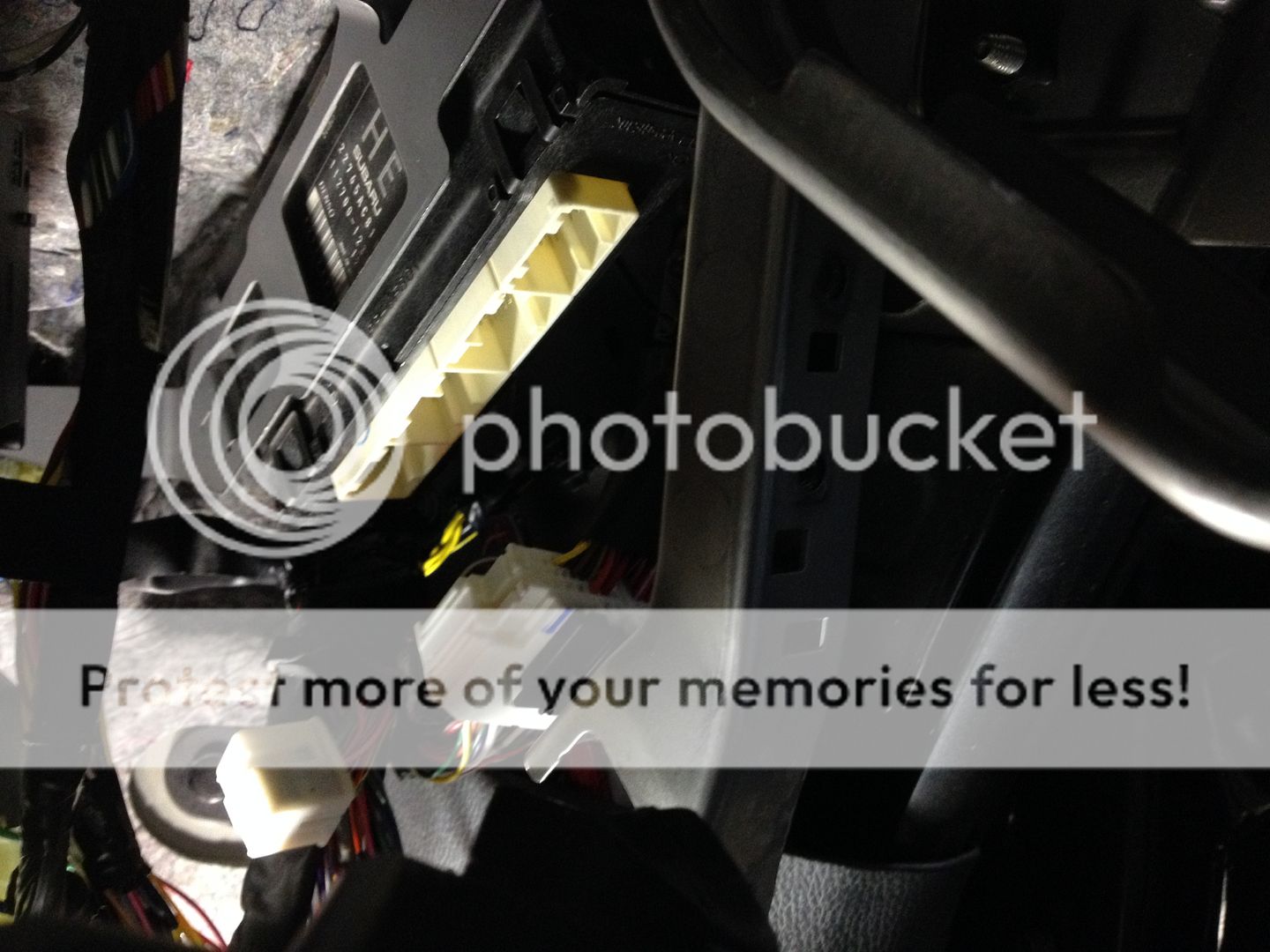

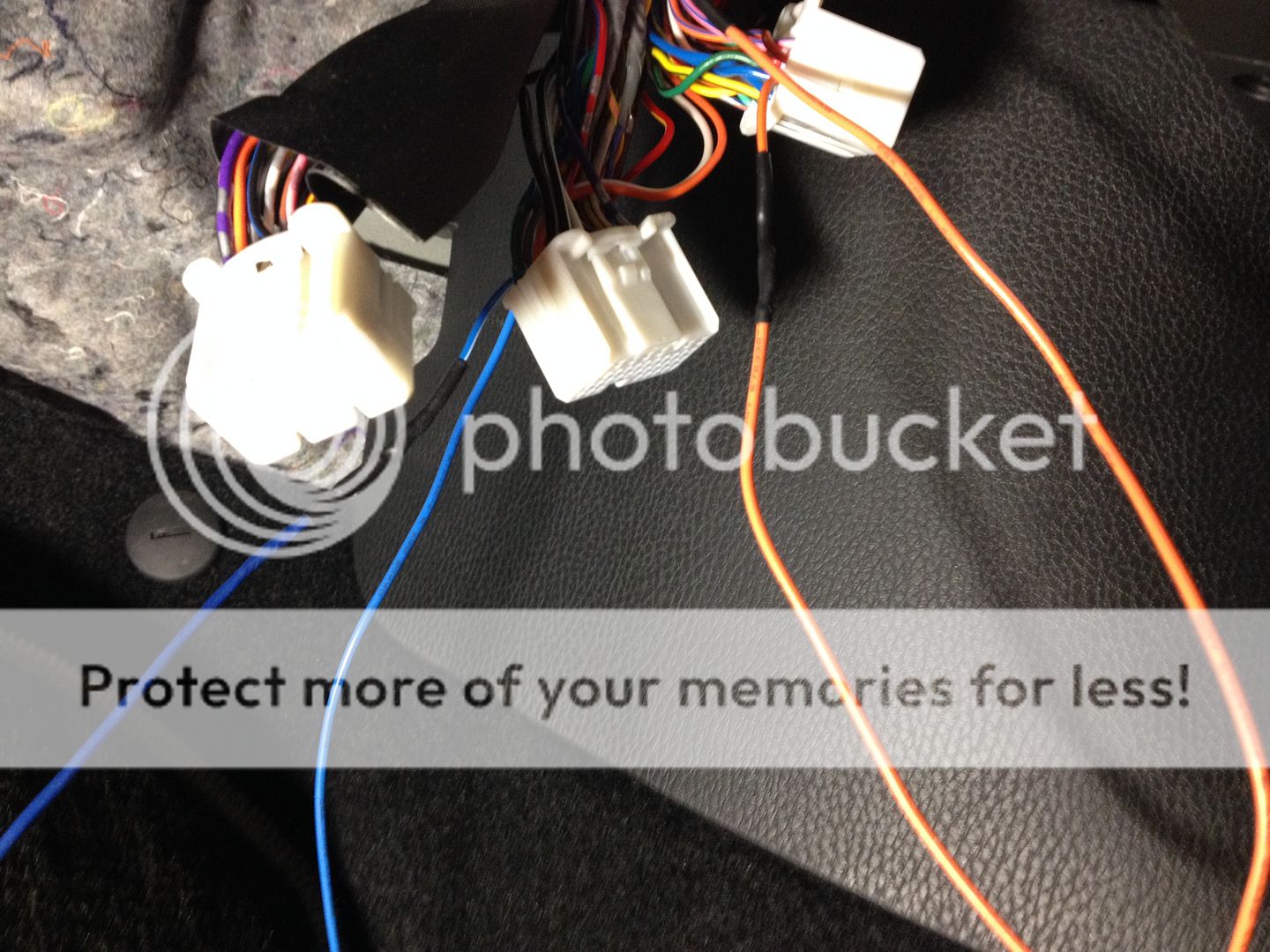

So i did this as well. For people that are curious, i actually did this under the pass dash at the main ecu harness.. I have no worries cutting and soldering wires, etc... Its not really too hard to get to. What i did was unplug the harness and then cut and solder.
Here is the ECU with the harnesses unplugged. Dont have to do this, but unplugging makes them pretty easy to work with.
Here is the wire for the rear o2, what i did was cut this in half. The wire that feeds back into the harness goes to your wideband sensor output.
The other side of the wire that goes back to the actual factory o2 sensor, i simply extended it slightly and then capped off via heat shrink. This will allow me to wire back to stock without having to pull the harnesses, etc. later if need be.
The wire for the CPC input. I cut this and extended it a bit, so later if i want the flexfuel input or for other uses, i can simply get to this in the kick panel without pulling the harneses, getting under the dash, etc.
The two wires cut and soldered/shrink wrapped.
Hope this helps anyone that wants to keep the wiring inside the car. Great to have this feeding and logging. Amazing how far off the stock is vs the wideband.
