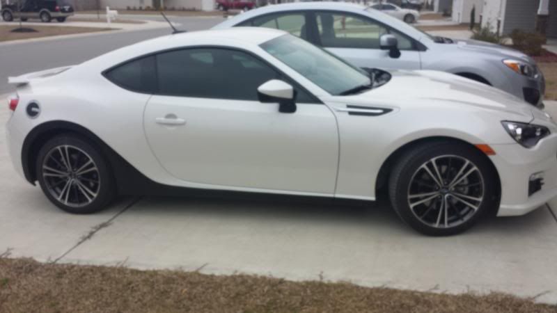

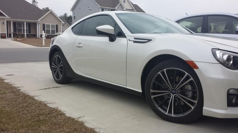

My BRZ
This is mine that I just finished plasti-dipping. Time to glossify!
Most people like to get rid of the wheel gap. It looks like you've added 5 more inches of wheel gap to the rear.
Needs 8 inches lower
It looks way better in person, especially with the glossifier I did today. The wheel gap that is there shouldn't be there for long

I'm just teasing. Black is very hard to appreciate in pictures. Can't wait to see the results!
