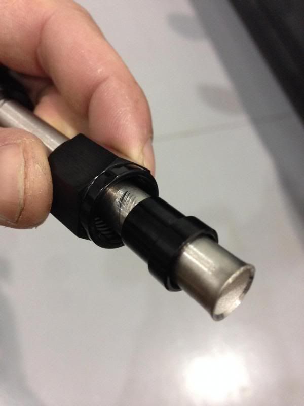

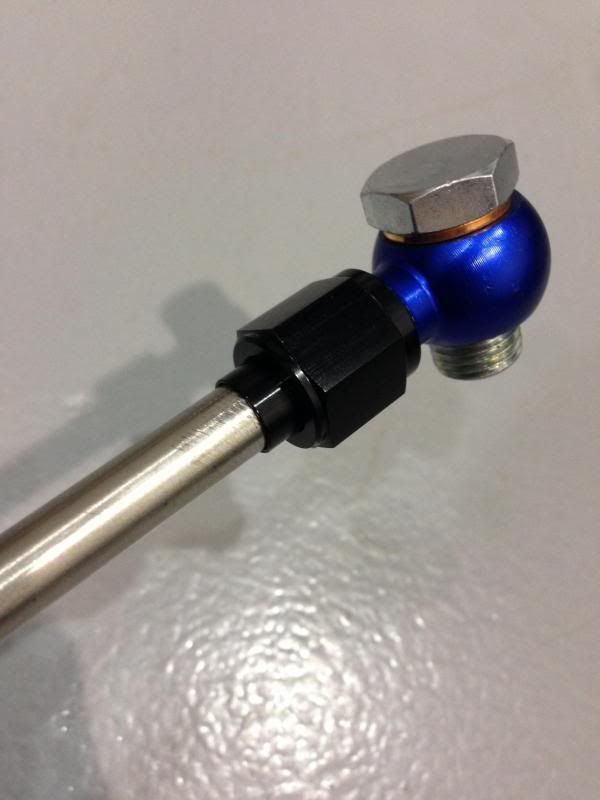

Also got my flaring tool in so I can try out making hard lines with a AN nut and sleeve. This will be the water lines for the GTX35.
Pressure testing my first attempt, it passed.
These lines are pretty cool, three parts to them. The flare, 37 degrees to be exact. Then the sleeve and nut pull it all together.
