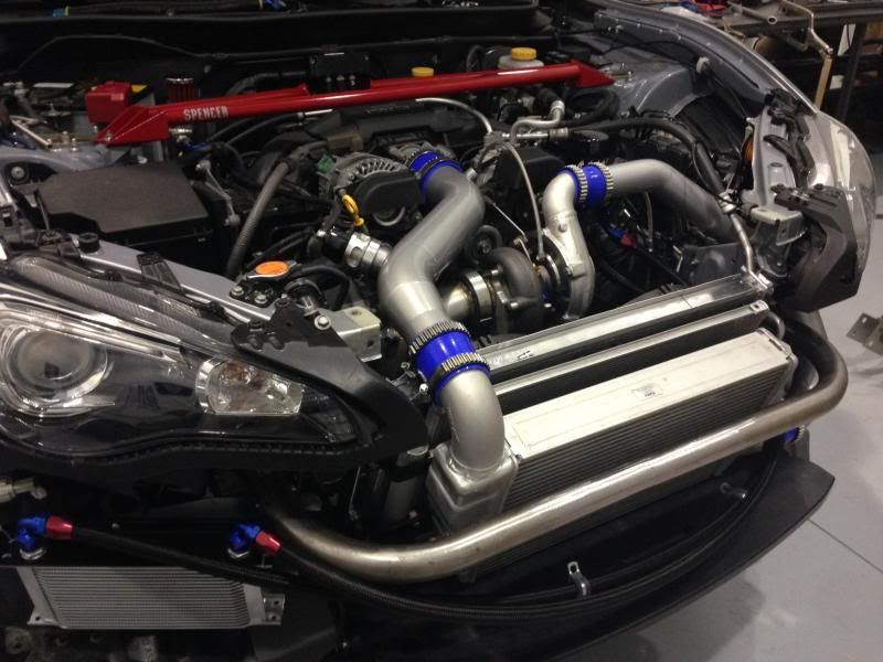

Small update, intercooler piping is back from powder coat and looks great.

Lookin good! I like the grey.

How much is that intercooler going to restrict airflow to your radiator? Any concerns of overheating?
Cross that bridge when we get there, the intercooler is tall but not very thick by intercooler standards. As always there will be a development of this setup, I don't expect this to be a one and done project.
I will certainly be welding up my own intercooler for this when I settle on a design. The price of quality intercooler cores in custom sizes sort of prohibits making a bunch so this evo intercooler was a steel since its exactly the shape I wanted.
