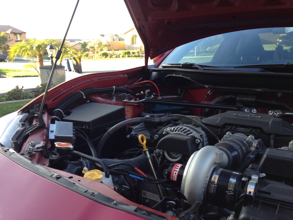

Finally completed my TQ250 24V install today. @Robftss kit with @shiv@vishnu 's tune with help from @WRB5titch, and @Sojhinn. I had a bit of an ordeal mostly due to my own rusty wrenching chops. I'll write that whole thing up manana.
For now, I will say this. After properly installing the kit, blasting all over So Cal for hours, and coming home and checking the logs everything written in this thread by Phantom ESC owners/testers, Rob and Shiv themselves are true.
1. The whole system installed in 2 hours.
2. Done properly the hardware install is EASY
3. Done properly the software install is EASY
4. The car is instantly transformed. This is no exaggeration.
5. The car gets even better (quicker, and faster) as the batteries condition, warm up and the ECU learns.
6. Rob and Shiv's customer service has been second to none on this board. I don't know how they do it. GMTA or something.
7. Can't wait to add back e85+ a header for 20-30whp cause I'm greedy and not afraid to say it.
8. For the performance, price and ease of installation, nothing touches the Phantom ESC + Open Flash Tablet tune. Nothing even comes close.
That's about it for now. Plenty more pics and impressions coming up. Oh and thanks @VR46 for generously providing relays to us new Phantom Supercharger owners. What a dood!
After blowing the tube you were good?
Haha actually it needed a little more than a blowjob.
I dun goofed!
Lesson 1. Always dress and secure your wires before driving the car.
All is better now
Ouch .
IKR - Let's just call it ring rust.
Notice all of the lovely zip ties and wire loom in the final installation.
Never again.

Took a cue from @Sojhinn and cleaned things up under the hood today.
Also removed the front bumper and shortened the intake snorkel as suggested by @shiv@vishnu
VR46 is offline   Reply With Quote
That looks great! I need to do cleanup in spring
