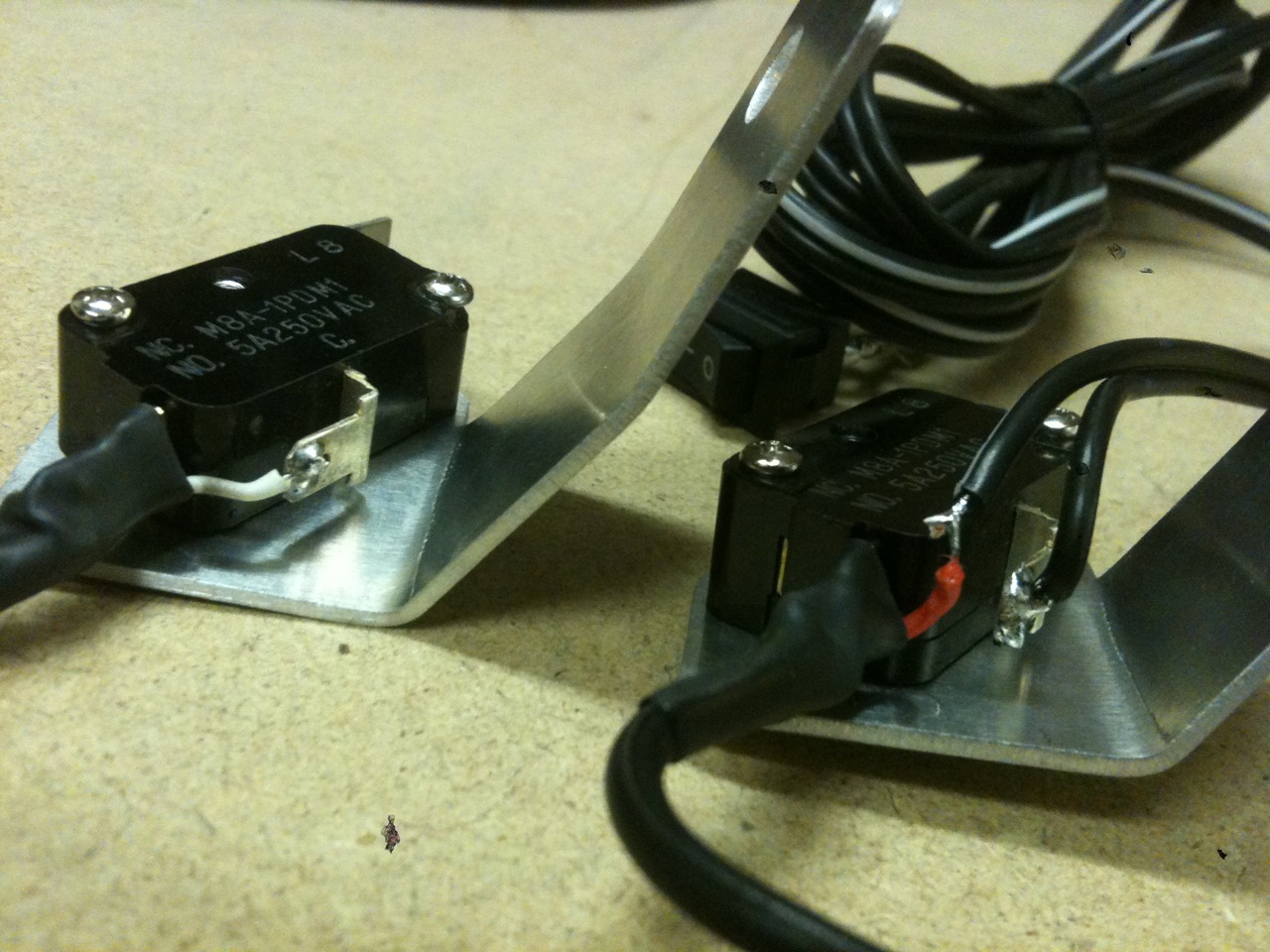

Originally Posted by Robftss View Post
Attachment 66949
SPM mod. *this is for track KERS style testing, not needed for DD,AutoX,drag*
Left pic is stock WOT.
Right pic: de-solder exposed wire, solder wire extension (~24ga) to switch to 'open' circuit.
IMHO the SPM switch should be mounted near the gear lever center console...so when you shift the switch can be activated.
There used to be shift knobs you could buy with a switch built in. Wouldn't that make even more sense? Just thumb the switch forward or backward when you grab the shifter?
Originally Posted by Luckrider View Post
Way more work than you think it is, and, you would need to have a working range on the rack or something.
Modern cars know the steering wheel position: there must be someplace to tap in.
Necessity may be the mother of Invention but Desperation is quite often the father.
“Sex is like Bridge. If you don't have a good partner, you'd better have a good hand.” - Mae West
Papa said, "son there's a lot of evil temptations out there. Best to try 'em all so you know which ones to avoid."
