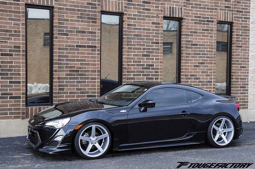

Originally Posted by Killerbee View Post
Hell no! And you really want to use 225 tires on a 10" rim?
either you're making a bad joke or you do not understand what those sizes mean. Do you have a picture or something of what you want to achieve, this may help me understand what you're looking for and I may be more helpfull than this.
This
These are the wheels, 19x8.5 front 45 offset
19x10 back 50 offset
On my wife's FRS I'm running 18x9.5 square 38 offset with 225/40, so I'm wondering if I can even fit a 10" on the front with that offset and still clear the coilover.

Originally Posted by Kwise1 View Post
Attachment 65476
This
Attachment 65477
I dont think a 10" Rim with +50 will clear the front, but it depends on your coilover. Check your inner struits, if you have on your current setup more than 1.7cm space between the rims and the inner struits it will work.
I guess you know this, but 225 tires on 9.5" rims, or even 10" is anything else than save to drive. I just wanted to mention it.
