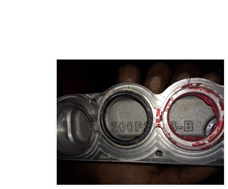

Originally Posted by CK_Bladesmith View Post
What if it's leaking down into the manifold from the laminova core?
That's the problem I had, the O rings in the core did not seal properly causing boost to leak into the cooler and manifold.
How you pick this up is you will notice coolant dropping each time you drive and give hard pulls. Should see coolant which came out the bottle cap.
Also the car will feel very jerky down low.
you mean the o ring strips on top?
I know mine were definitely in place. Also, I don't ever get on the car, because i'm in the process of getting some issues tuned out, so I am driving very easy. Plus, no jerkiness down low of any kind. Or coolant coming out the bottle cap.
Not the o rings from the adapter, the o rings inside the actual core. If you not pulling then you could be sucking coolant into the manifold.
This is worse case scenario
Top up and run car again if you notice coolant dropped again to low mark you may have a leak or you did not top enough coolant causing air lock.
I don't remember fittings going into the actual core, unless I'm misunderstanding lol. Either way I'll just top off and go from there.
If you open up the core these are the o rings sealing the coolant running through the core. Look at the condition on my o rings, can understand why they did not seal, causing it to leak into the manifold.
