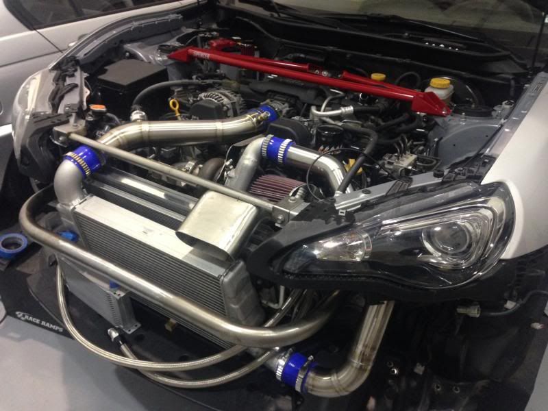

UPS man brought more puzzle pieces today,
Mishi oil cooler kit that I will make my own lines. Innovate Oil pressure/temp combo gauge, and some grimmspeed hood dampers so I don't need to use a broom handle any more.
Also some RE-11A tires in 255/40/17
Lines almost work but its not good enough for me. And if you havent noticed Im having a hard time choosing between black or blue couplers. Every detail counts
The Build Thread
GT28RS - eBoost2 - 3.91 Final Drive - Supra LSD

Im having a small love affair with TurboSmart products on this build. Here is the eBoost2 boost controller and there constant tension clamps. These things are sweet.
The fans have come in from Spal, along with material to recirc the waste gate and a vacuum manifold.
The Build Thread

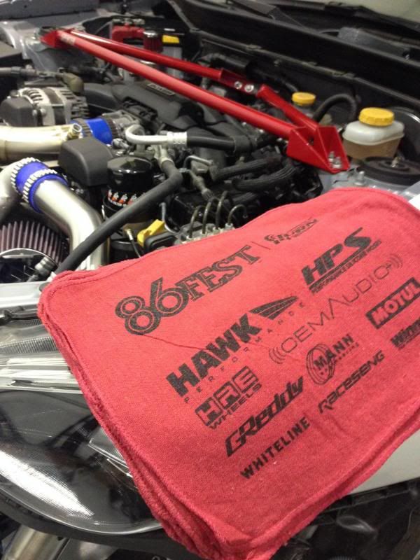

Got some sweet shop towels from my distributor, also you can see the TurboSmart clamps in the back ground.
Started making hard lines for the crank case breather, no more messy hoses.
Tossed in the Spal fans, they are a little closer then I would like to the down pipe. There is actually more room then it looks in this pic but I'll see what I can do.
The Build Thread

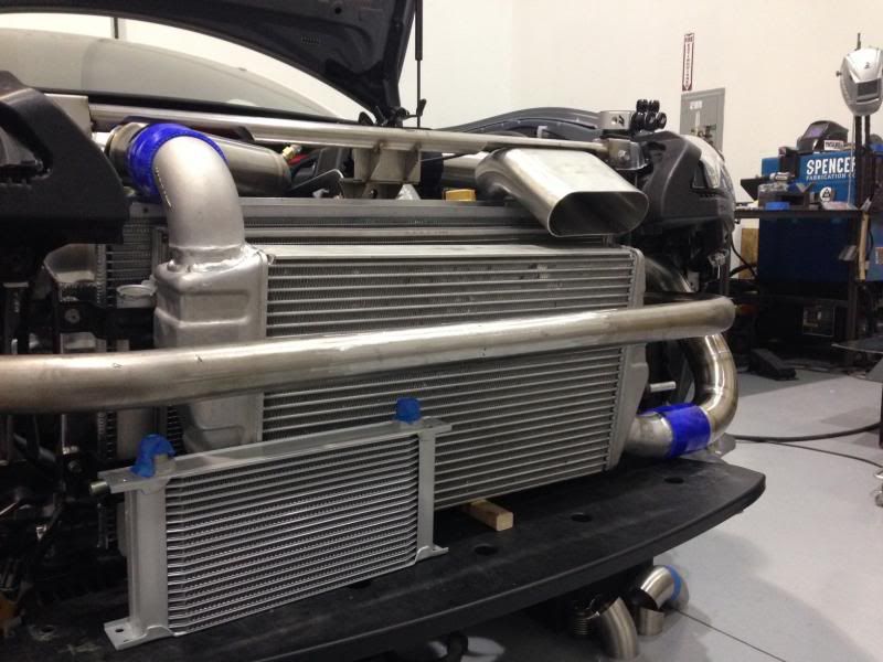

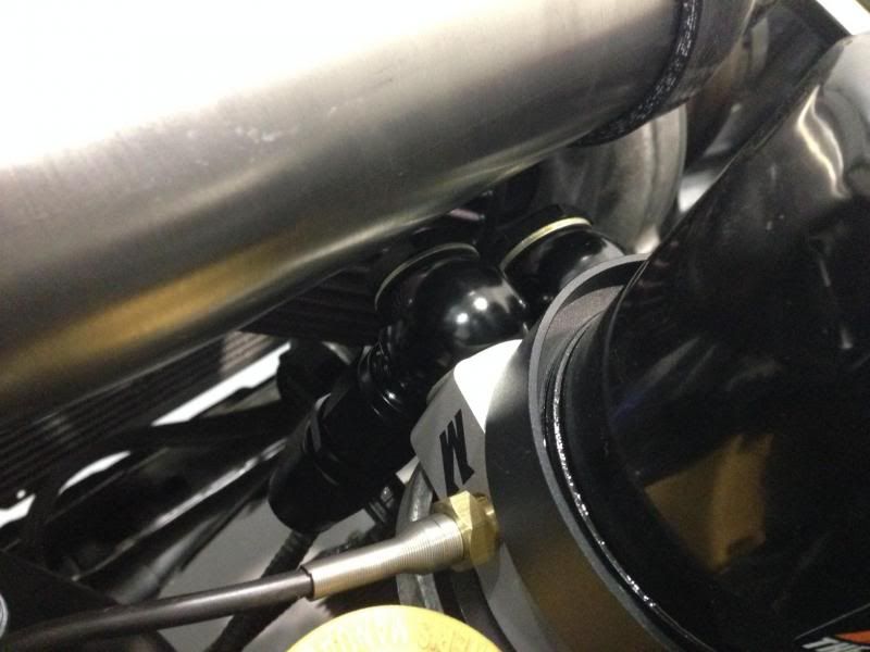

Chip chipping away. I have changed the upper section of the charge pipe coming off the turbo to 2.25" to give just a bit more clearance by the oil cooler fittings. Other trivial things done like mounted the boost control solenoid that came with the eBoost2. Work has been busy which is always good but means less time for turbo.
The Build Thread

thanks, this my first setup using the TurboSmart clamps I kept seeing them on a number of high end time attack cars so I figured I would give them a try. Ive used just about every other option before.

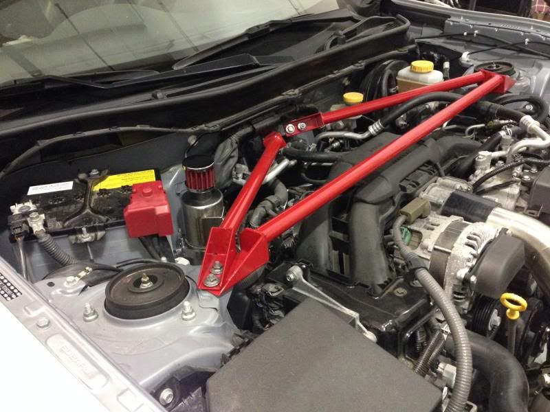

Originally Posted by mrk1 View Post
Just about done the catch can.
Made a super simple bracket that sandwichs under the battery to mount the can
Also welded on a IAT bung in the upper charge pipe so that decides that the car will be tuned speed density. I was going back and forth for a while on that.
Awesome catchcan much better looking than any of the others ones I've seen on forums. If you dont mind answering a noob question...these are just to keep the engine/intake free of misc gunk correct? Help keep stuff from collecting on the injectors and valves?
I'll cross that bridge when it happens. I'd rather open the fenders grills and let air out that way. But I'm not opposed to a tastefully vented hood.
You could also made some vents that exhaust up near the windshield wipers rather than modifying the hood but the fender vents would be cool since they are not functional via stock.
And I suppose this would be a good time to thank you for sharing your fabrication skills. I love how it is just radiator after radiator in the front of your car and the air inlet is really cool too...are you going to box-in the intake's there so all your airflow doesn't bypass the radiators? I am also going to jump on the party line and say if you are going to become a vender and sell the trunk brace and hood brace I would like to be added to the not-so-short list
