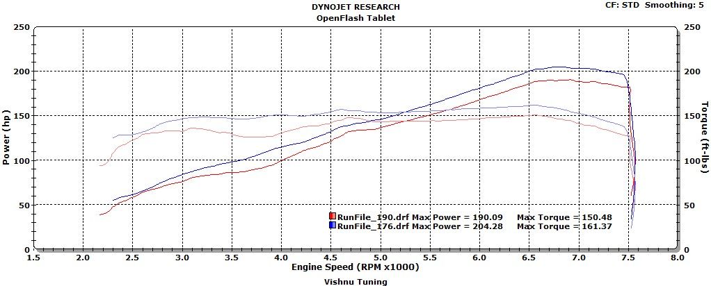

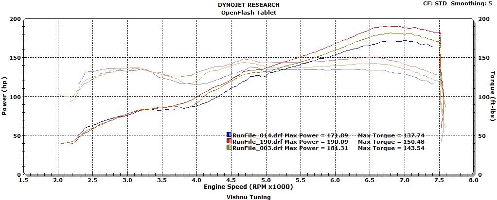

I don't understand what your complaint is. We compared our new UEL header with both the stock header and an EL header on the same car, same dyno, similar conditions. Stock car with tune only goes from ~171->180whp on 91oct. Add UEL header and flash appropriate tune, power goes up to just over 190. Add E85 and flash appropriate tune and power goes to over 200whp.
In fact, our header-only car running E85 made nearly identical power as a full bolt-on car running a rather well known (and twice as expensive) header and E85. Midrange dip gone too. Same dyno. Nearly identical tune.
From my perspective, you have come to a conclusion without fully understanding the data provided.
Stock
Stage 1 (OFT only)
Stage 2 (OFT + OpenFlash Header)
91oct
Stage 2 (OFT+OpenFlash Header) on 91
Stage 2 (OFT+OpenFlash Header) on E85

These are much better post than the ones provided before. The before mentioned plots make it look like the torque dip benefits were purely from the header not the tune. As in without the header the torque benefits were very similar. I appreciate you taking the time to plot these graphs as I feel the much better represent your product.
And I still extend my offer for testing if you want some third party results.
