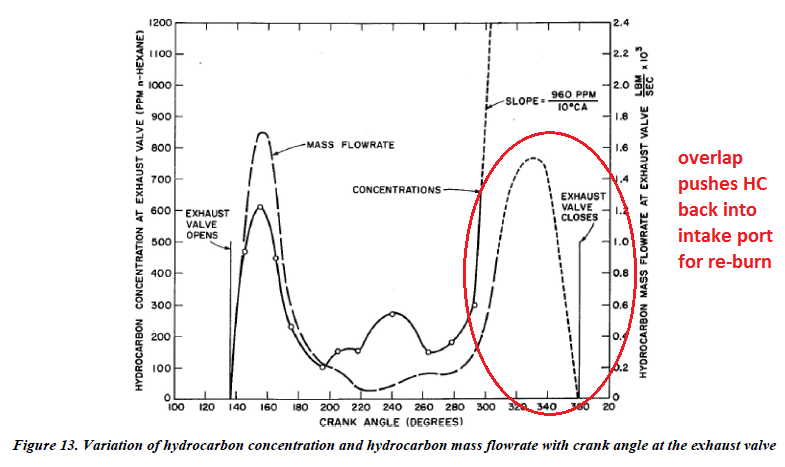

High RPM & retarded spark provide heat to warm up the cat. -15 degrees (BTDC firing, so 15 ATDC firing) is about average spark retard on a modern direct injected engine during cold start. I'd have to take a look at the injection timing. If it's running just DI, you'll usually have two injection events, roughly 50/50 or 60/40 split between the first and second event. The first is in the intake stroke, around 240-260 BTDC firing. The second is on the compression stroke, roughly 40-70 BTDC firing. This stabilizes the combustion enough to allow retarded spark. If the engine is cold enough you'll just see a high rpm idle, single injection event, and maybe less retarded spark. It's focused more on warm up and less on emissions, because there are no emissions tests taking place colder than 20F/-7C ambient.
I haven't seen charts on the cam grind vs crank angle, but the valve overlap burns up the HC emissions if intake valve ends up opening BTDC intake. It's commonly used on Japanese cars.
What happens is, the HC emissions are ejected mostly when the exhaust valve opens and when it closes. If the intake valve is open at the end of the exhaust event with piston still ascending, that HC goes back into the intake port where it can be burned up on the next cycle.
One last thing to keep in mind. The stock tune was designed to start and idle ok on really crappy fuel (does not vaporize well) in very cold climates. That's one of the reasons why it behaves the way it does. There are special lab-grade "heavy startability fuels" that's used to test this. So there is a certain safety margin you are seeing in the stock tune. One of the side effects to that can be NVH concerns.

It has AVCS on intake and exhaust cams. Basically, a hydraulic cam phaser moves the cam centerlines. Intake cam can be advanced from the most retarded position, and exhaust cam can be retarded from the most advanced position. This allows overlap if the cams are phased far enough.
Now, it depends on the grind of the cam. If the intake valve opens at 20 degrees ATDC intake, and exhaust closes at 10 degrees BTDC intake, you need over 30 degrees of intake cam advance to create overlap and backflow into the port.
