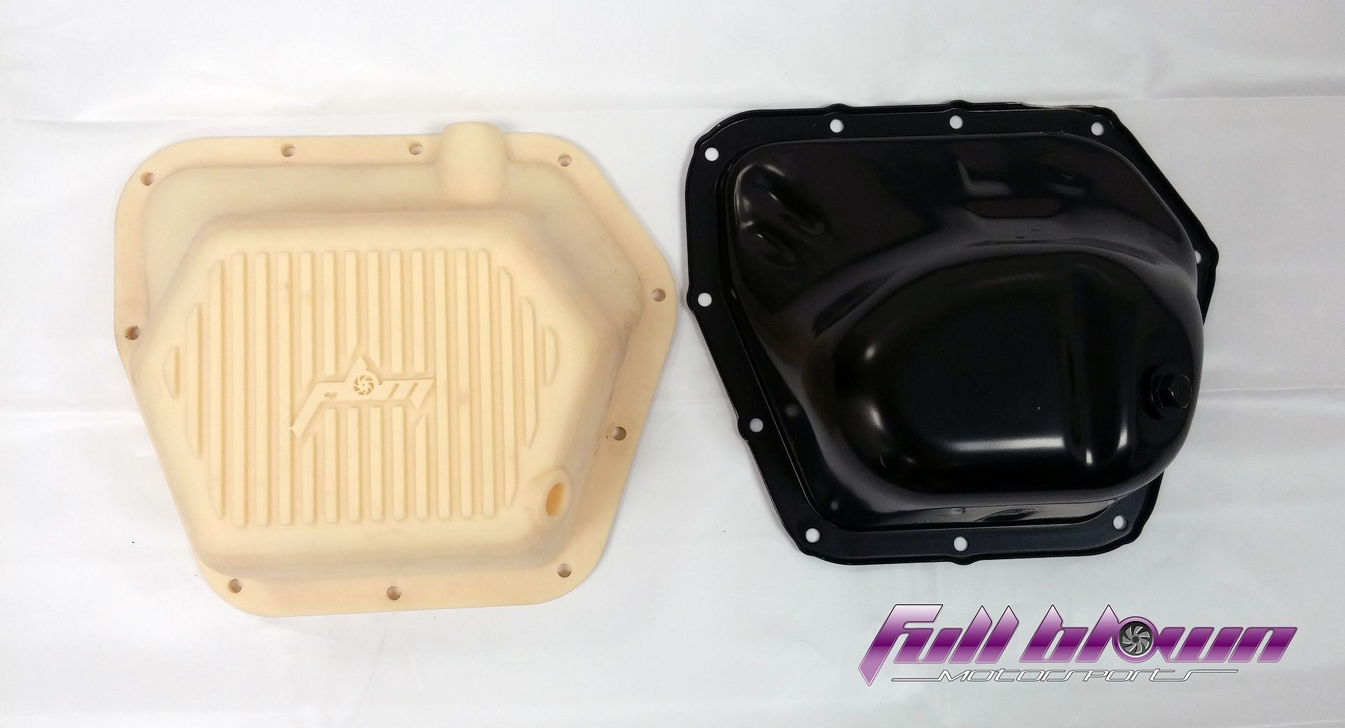

can someone ELI5 this part for me? What are the overall benefits to changing in to this oil pan? My car is in the process of being FI'd right now, and this looks pretty cool. I want all the cooling possible for my oil.
Extra quart of oil, what is the benefit to it?
A marginal cooling effect, if its negligible, then what is the point?
Does this only work for FB turbo kit, or any FI in general that taps into the oil pan?
Our pan will work with any forced induction kits out there. The oil return port is universal and can be adapted to fit anything you want.
The baffle inside our pan is designed to keep the oil around the pick up under acceleration and turns.
The extra oil capacity along with the aluminum construction will help with oil temperature, because aluminum dissipates heat better than steel.
The heat sink design under the pan allows air to flow through and help cool the pan.

Here is the comparison with an OEM pan

Nice,....very nice,...you guys are heading off issues before they even arrive for most of us,....or have you figured this out already on a test bed car?,....I know oiling is or will be an issue with this engine as people start pushing its limits. Also the cooling benefits will be a big plus with the increased capacity and fins,...an issue well documented.

Cool stuff. Let us know if there are any weight savings too.
Got any pics of the baffle?

No I haven't,....what concerns me is sustained cornering forces and a momentary loss of oil pressure causing rod failure in a FI set up with this engine.....it was strongly suggested to me by Ken Stout if I cant afford a dry sump system to at least run a accusump system,...obviously they ran into oil scavenge issues.... Although I'm not Ken's son Robert racing this platform I do think this oil pan is a step in the right direction for sustained high G loads.

No, we just added a baffle to help keep the oil around the pickup.
