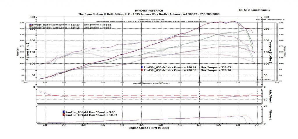

The powerband doesn't look interesting, but I really need some seat time in one of these to make a choice. Torque valley looks great, but I can't get over the low numbers - though it puts things in perspective...75whp stock at 3K RPM? Yuck.
Would you say that's around 300chp, @CSG Mike? And just to re-confirm: on Cali 91, on a CARB legal tune, stock exhaust?
Yes, this is on Cali 91 (10% ethanol... yuck), CARB legal tune, stock exhaust, stock header, stock cats, etc.
Compare to Drift Office's 92 octane, SD tune, full exhaust, front pipe, and HKS EL header.

For comparison purposes.... the kits are identical, and both use the same pulley. This is how dramatic the difference is with breathing mods with a supercharger. DO NOT use catless pipes with the CARB tune. The CARB tune is intended for cars with both OEM catalytic converters.
You can see how linear the gain is with breathing mods. As exhaust gas flow linearly increases, the power gain also linearly increases. Both kits eliminate the factory torque dip. Also of note, is that the torque dips present in the Kraftwerks kit is not present in the Jackson Racing CARB tune.
- CA 91 octane (E10)
- OEM header
- OEM front pipe
- OEM exhaust
Drift Office SD tune
- Washington 92 octane
- HKS EL catless header
- Motiv catless front pipe
- unknown exhaust
