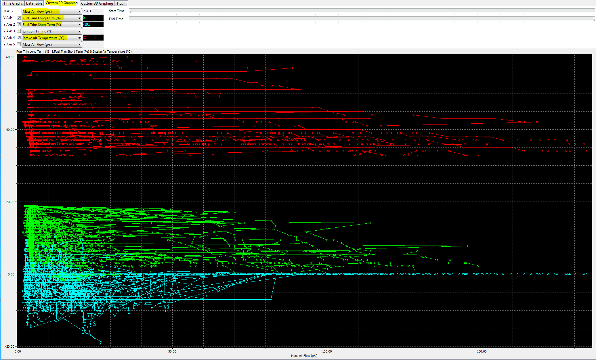

Originally Posted by jamesm View Post
Interesting to see the tools that you guys are using on the other side. This is what you'd do with the view in EcuTek:
Select 2d view, set the MAF g/s (or volts if you choose) as the X axis. You can also filter the datalogs by opening them with excel, sorting and deleting fueling modes (i.e. cl and ol), and re-sort by time and open with proecu. But with a decently sized log that isn't necessary. You get the trends quite accurately through this view. Generally go by the long term trims. The short will always vary a good bit.
Xero-Limit is offline   Reply With Quote
that's pretty much the same idea, only that the spreadsheets generally take the sum of the stft and ltft to get total correction %, categorize those, then plot the mean and mode for the suggested corrections (suggesting the more conservative of the two).
i'll be switching to ecutek (or rather, adding it to the list lol) soon so it's nice to see how their logging tools work. thanks!
