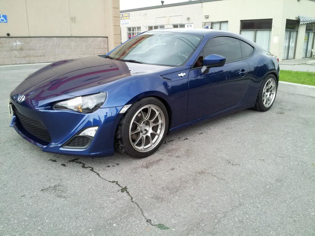

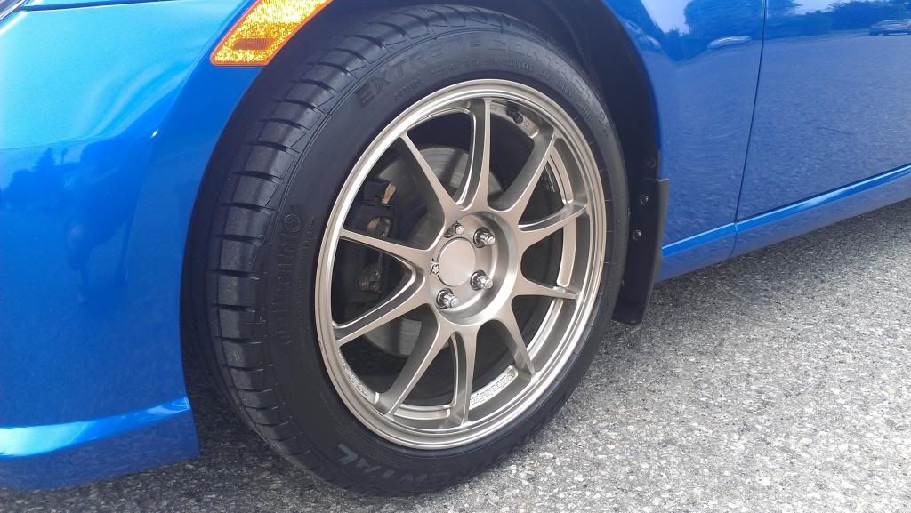

I'm leaving the bare aluminum for now. It sort of reflects the colour of the wheel and it isn't immediately noticeable that they don't quite match...
Thanks Kask!
