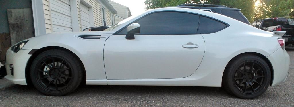

Not as good as Foobar's pic, but here you go:

Thats tight all black against that pearl....
All these pics with tcs is making me more inpatient to get mine set up.

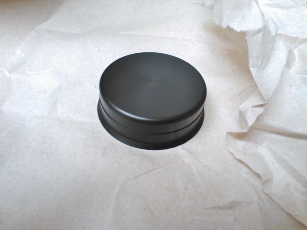

A few sets of plain aluminum caps are still available. These should fit all 5x100 TC105n's and a 56.1 mm hub diameter.

For those of you that are painting them remember to only paint the surfaces in front of the step (cap portion). If the hubcentric ring portion of the cap is painted they may or not fit back in your wheel.

I'll call the place tomorrow to ensure that they leave the inside of the cap alone. Is it sufficient to just have them do the outside of the cap from the face down to the edge of the lip? Like what is visible in the picture you posted? Is there any other part of the surface I can have them anodize?

The entire part can be anodized without any issues. Anodizing is very thin so you shouldn't have any issues there.
Some people previously mentioned that they would be painting, or in your case clear coating the caps. Paint can be much thicker than anodizing and could make a very tight fit. So if they were to be painted only paint the face down to the step (red line in pic below). This smaller diameter doesn't fit snug in the wheel like the other portion of the cap.
