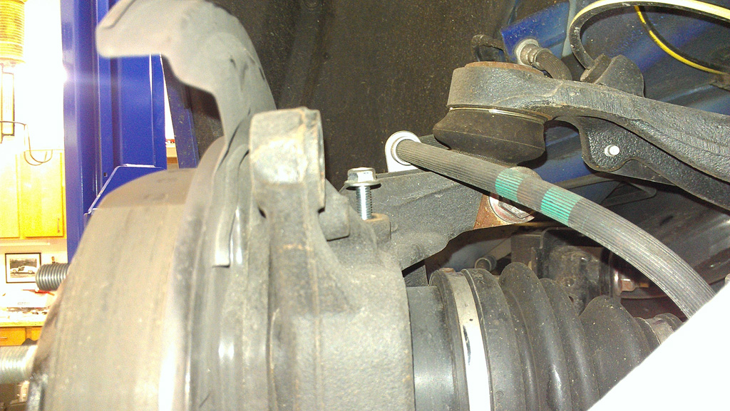

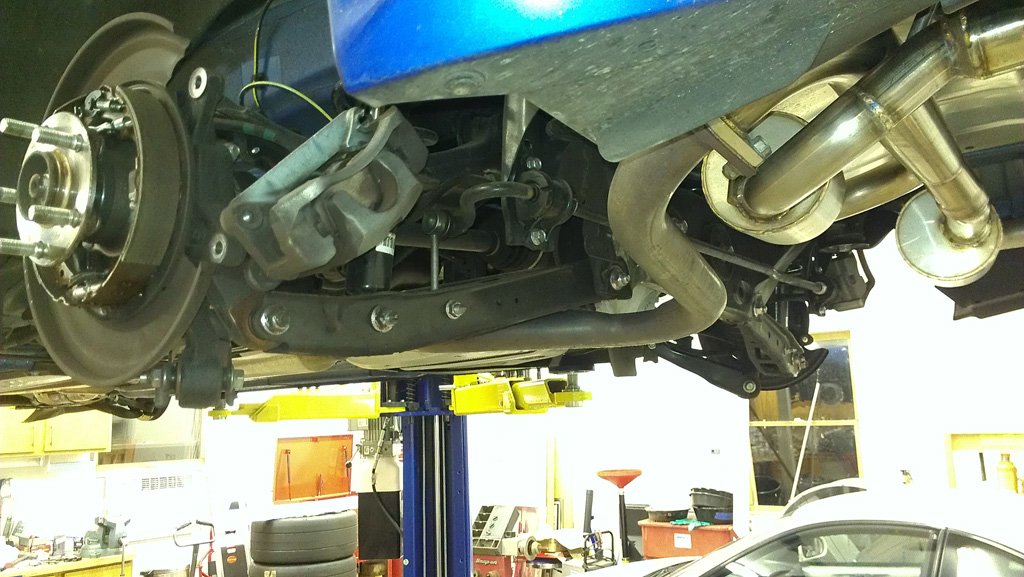

5. Remove rear brake caliper assemble (caliper, bracket and pads can all be removed together) and hang out of the way, as seen here:

7. Remove the speed sensor (10mm) on the top of the hub, the bolt is visible in this picture:

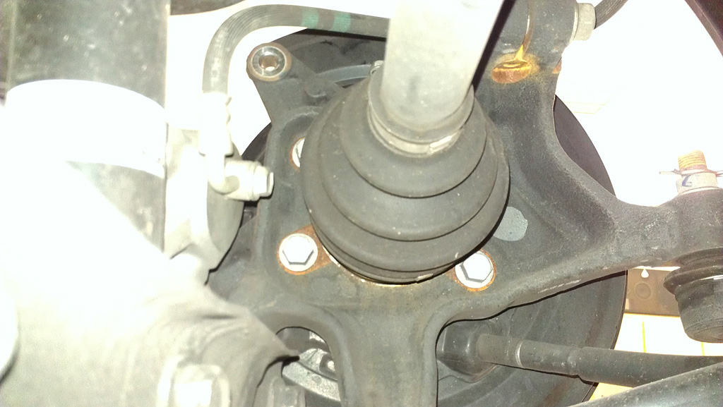

8. Remove the four bolts (14mm) bolts that hold the hub to the rear upright, three of the four are visible here:

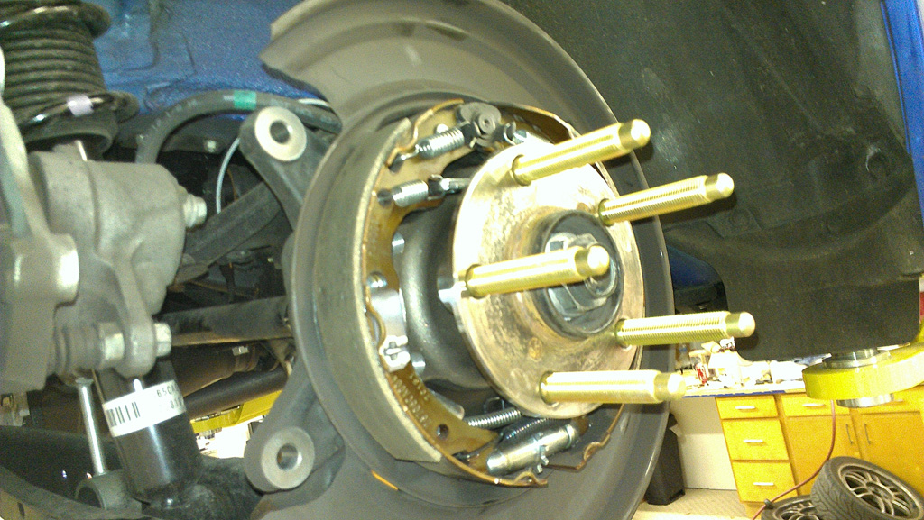

9. Once all of them are removed you should be able to pull the hub assembly away from the car, push on the end of the axle to avoid the axle hanging up on the hub. 10. Once removed, use two of the bolts to secure the drum brake assembly to the car so that it doesn't hang:
11. Remove old lug studs using a press, or ball joint tool as shown above.
12. Install new studs using a press (if you have the right pieces, I couldn't use a press for the rears while I could for the fronts).
