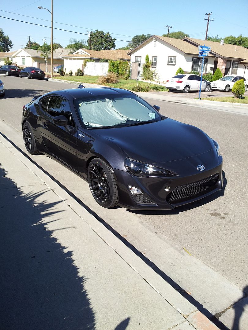

Finally got my wheels! 18x8.75 +35 Chromium Black, lowered on H&R Sports, 225/40 tires, no camber bolts.. yet

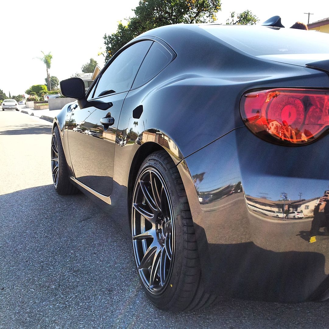

Got it mounted today! Need moar low!
