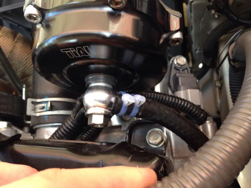

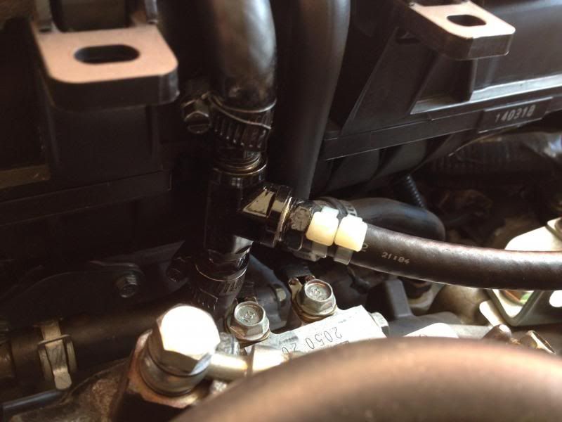

Cutting your spring is a horrible idea. With the tial Q BOV its very important to use a 1/4" or bigger vaccum line to supply it like the instructions says. And it also helps to tap the vaccum source as close as possible to intake manifold for quickest response. Mine fluttered before I did these things and now it doesn't. I'll post some pics to of how I have mine tapped

I don't think the existing tee for your other stuff should matter but I think the blow off valve should have its own dedicated tee in front of the other tee. I used a 3/8" -3/8" to 1/4" tee on the brake booster line right behind the intake manifold, with 1/4" inner diameter reinforced fuel line as the vacuum line. Please excuse the zip ties, the line is tight it's just an extra precaution....
