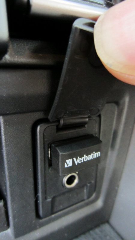

I used this and have both AUX and USB still usable. Not cutting of wires. Just pop out old device (stock USB/AUX input) and replace with this. Plug USB and 3.5 into aftermarket HU and you're golden. It really just pops in and out.
AX-USB-35EXT (http://www.sonicelectronix.com/item_...USB-35EXT.html)
