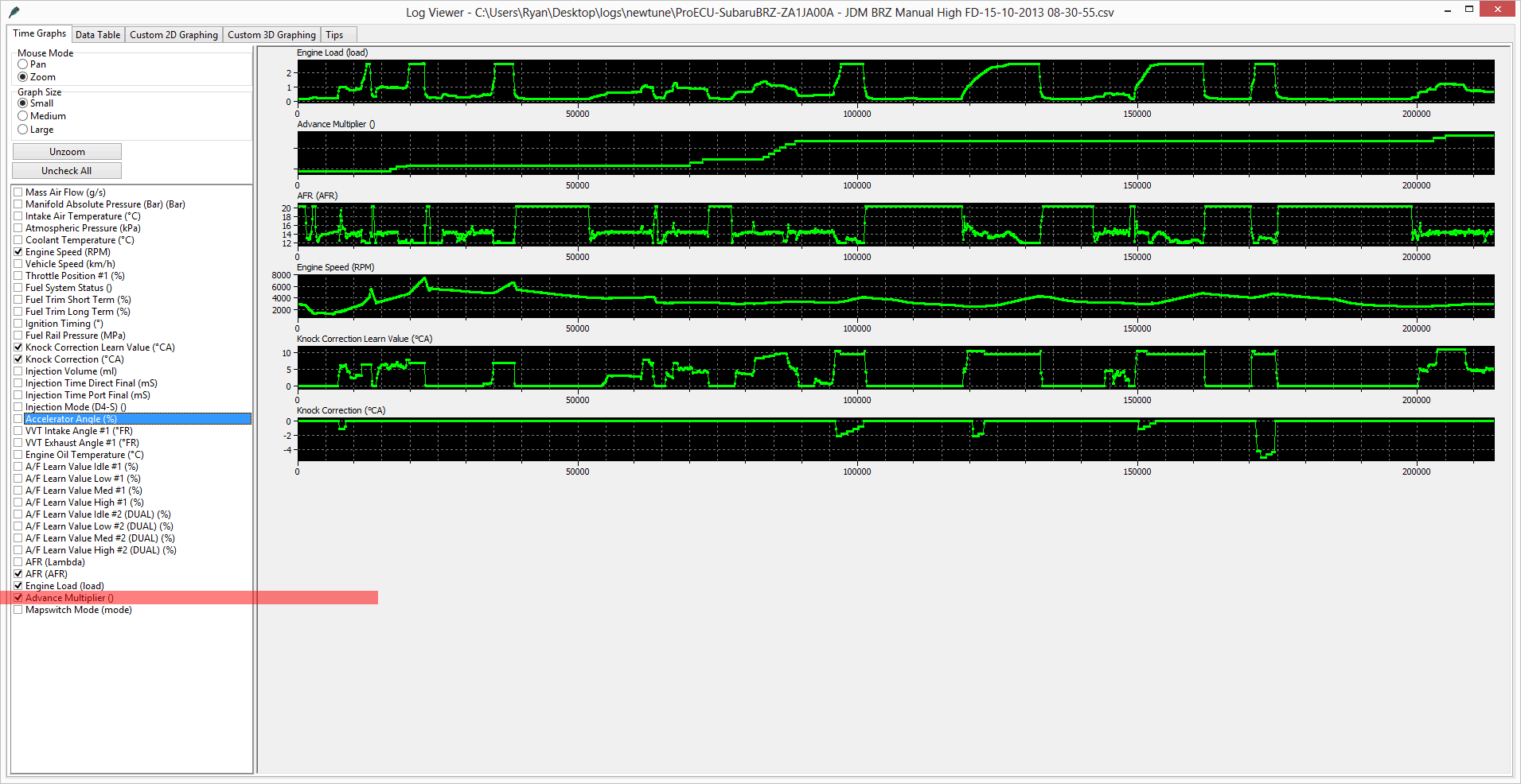

Originally Posted by gdrider77 View Post
Not sure the "1" i mentioned is right. In ECUtek, logs, where is the IAM reading? I dont see that in my logs? I see something that says "advance multiplier" is that it? I Highlighted it in this image....
Your advance multiplier is not pegged at 1.0 ... it is responding to the knock. In the snapshot you provided it starts off low and slowly climbs up. What is interesting is it is climbing up even though there is knock events....
Yeah, in that snapshot your right it climbs. in others it has sat right at 1. It seems to change slightly.
For some reason in the snapshot it climbs, but looking at the raw data in the CSV from your first post, it seems to be 1 for the whole log.
Ok, so probably should clarify, the snapshot is from a log i just happened to have open and was from today. I was simply using that image to point out the multiplier setting, as i didnt have it in the original snapshot.Its not a graph of the specific logs. I changed it back, so now its referencing the right one.
Sorry, bout that, hard enough to ask for help, but probably shouldnt be confusing everyone like that.
