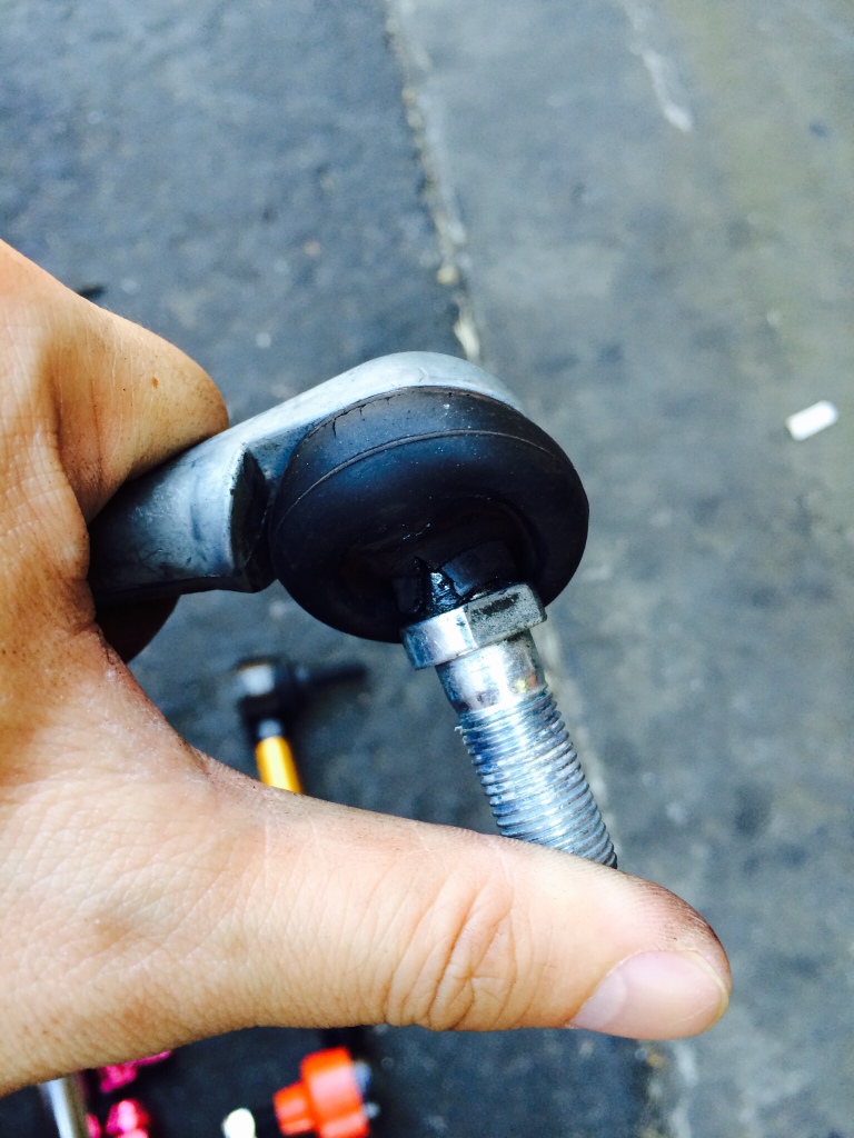

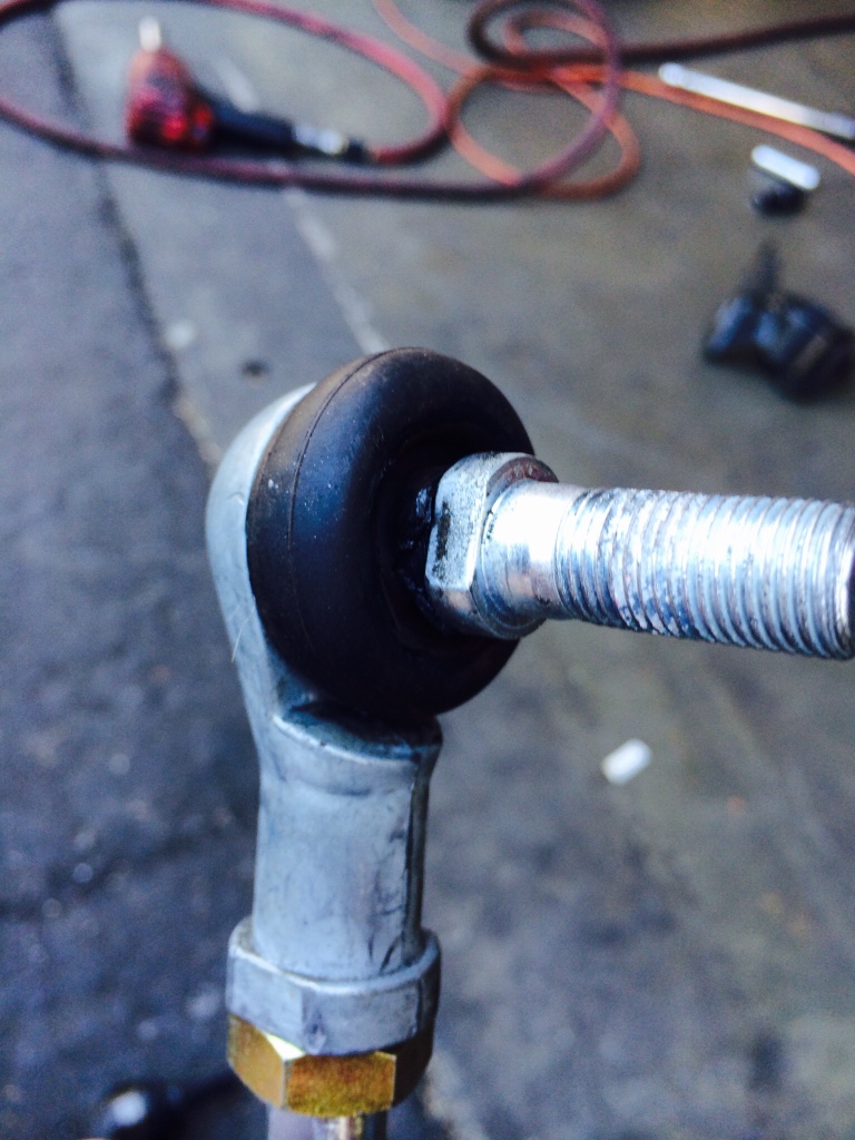

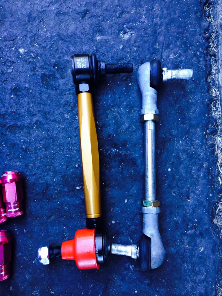

Stance Super Sport coilover install/review
Don't put on these crappy ass endlinks!

Originally Posted by Jeeper_x View Post
Attachment 90517
Attachment 90518
Attachment 90519
How long did you have them on for them to fo bad like that ?
Did you track/auto cross the car?
07jazzrs5gt86 is offline   Reply With Quote
