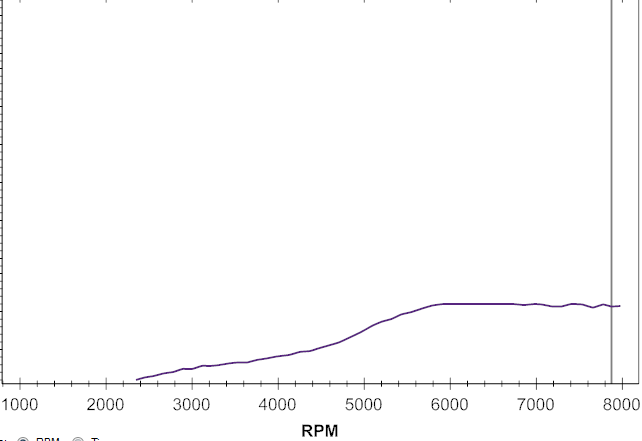

Originally Posted by Ross View Post
It actually hits full spool well before 6k. Next time Fabron comes in I will log it and post the plots. Also the turbo is not rated for 600. It is only specked to flow 56lb a minute at high pressure.
Next time I see Fabron I will get a log of his boost plot on the street with his aem
I assume that's a boost plot, if so it seems to spool properly between 5-6k. Not sure i'd call that 'well before 6k'. All turbos will show a few pounds of boost they spool properly, but you'd need a turbo speed sensor to demonstrate what's really going on. Of course you could be limiting the boost at lower RPM due to surge problems?
It is what it is though, for 6-7k rpm street racing (which this seems to be for going by videos posted) then it's great. Each to their own and all that.

I had made that statement when his max boost was only 10psi. At that point I had it hitting much harder, but traction was an issue then. I have set his boost control to taper in so he does not just blow the tires off. If the factory ecu could properly log it it would not be an issue as the turbo already has the previsions for a speed sensor on the compressor wheel and the sensor it self is cheap. Possibly when we do a built motor add a secondary logger as we will have time for things like that then.
