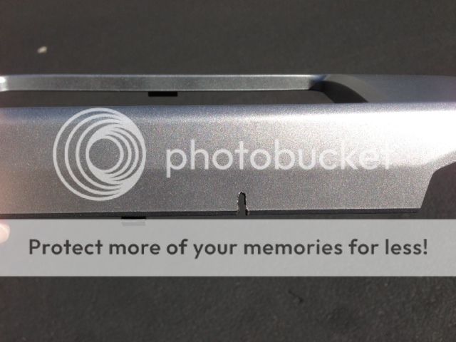

I thought I might share some of the details from my installation yesterday.
I wanted a stealth look for the indicator/arm switch. Also, I HATE the passenger warning. So I covered the passenger warning with the arm button. First I marked with a sharpie where I wanted the wire to pass through the radio radio surround. I then drilled three 1/8" holes and opened them up with a knife:

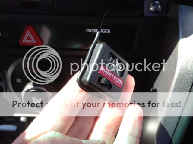

I opened the back of the indicator to see if there was a possibility to have the wire exit from the top of the box...there wasn't much room in there so I went to plan B. I put three drops of crazy glue on the outside of the unit and attached the wire to the unit.
Here's how it looks from an angle that you'll never see:
And here's how it looks to me...the only person that matters.

Gary in NJ.... That's a great spot, but I don't like the wire going around the side like that.
I wonder if the front of the switch can be flipped so the wire would be on the top? Rob??????

I'm not thrilled about the glued wire on the outside of the unit either, but the truth is once it's in place on the black surface of the IP, it isn't at all noticeable. Surely not while I'm driving...your eyes are drawn to the bright voltage reading.
The wires that enter the indicator are soldered to the switch and the circuit board. I felt if I tried to relocate the wire within the unit that one of those connections might not survive to move. Since there are so few "extra" components of this system in existence I felt it was better to tack 'em to the outside then risk rendering the system inoperable.
