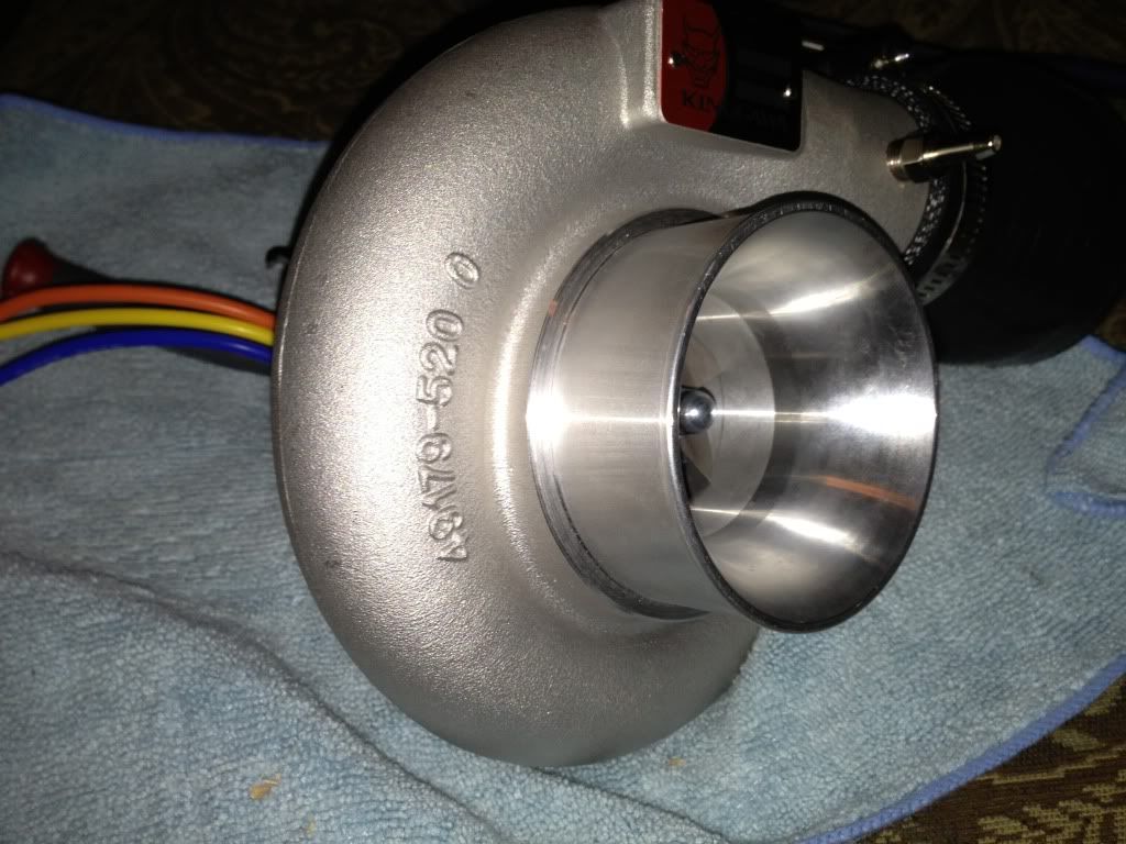

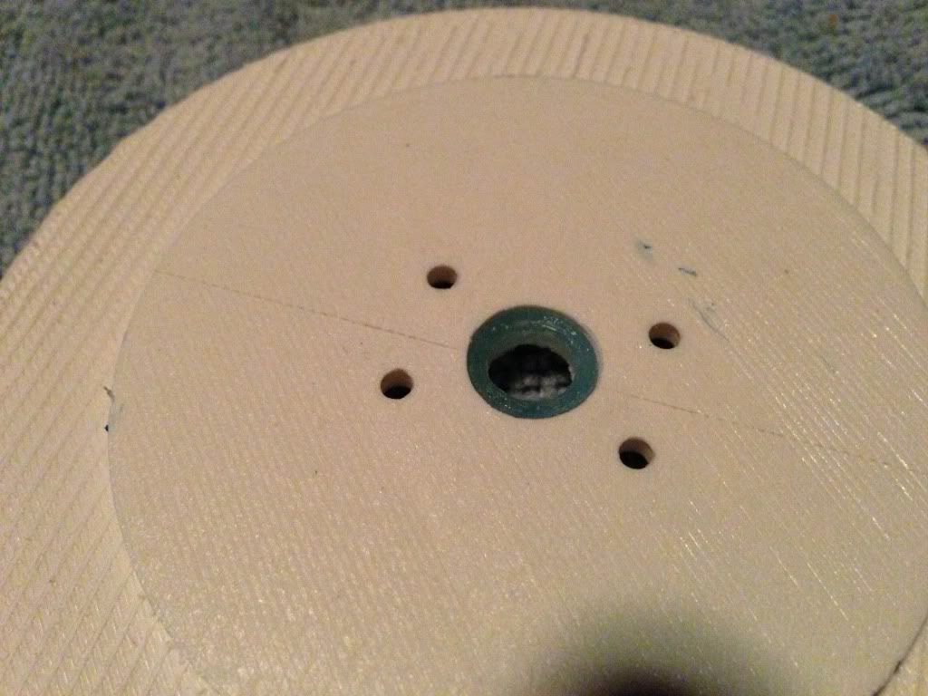

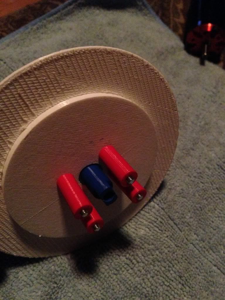

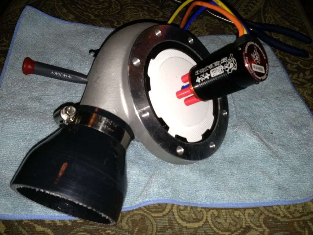

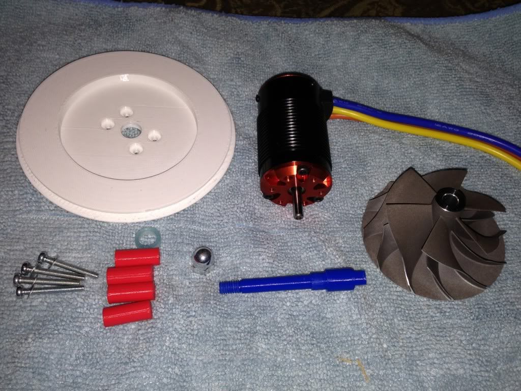

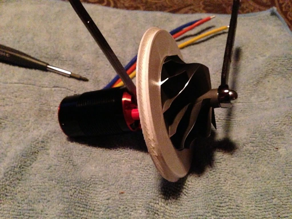

For simplicity sake I've decide my first prototype will be a 12V system. I'm also going back to one of my earlier designs because fitting the compressor wheel directly to the motor shaft was proving to very problematic.
I got my motor today so I got busy in CAD on designing all the parts.
Parts for test fitting are hot off the 3D printer (3D printing is awesome!). All the parts fit great so I'll be ordering all the off-the-shelf hardware bits & metal to machine tomorrow.
The parts:
-Backplate (3D Printed White)
-Bearing (3D Printed Clear)
-Shaft (3D Printed Blue)
-Spacers (3D Printed Red) x4
-Screws & Washers x 4
-Compressor Wheel & Nut
-12V Brushless Motor
-Compressor Housing
-O-Ring (Missing)
The bearing is pressed into the backplate. An O-Ring would also be added in the notch but I don't have one yet.
The shaft goes through the bearing
The screws with washers are placed through the backplate and spacers are added to form the motor mount
The motor is attached, and the compressor wheel is then placed on the shaft. A nut on the end of the shaft is tightened with one wrench while a second wrench is used to hold the shaft
The assembly is then placed in the compressor housing and secured with a snap ring
