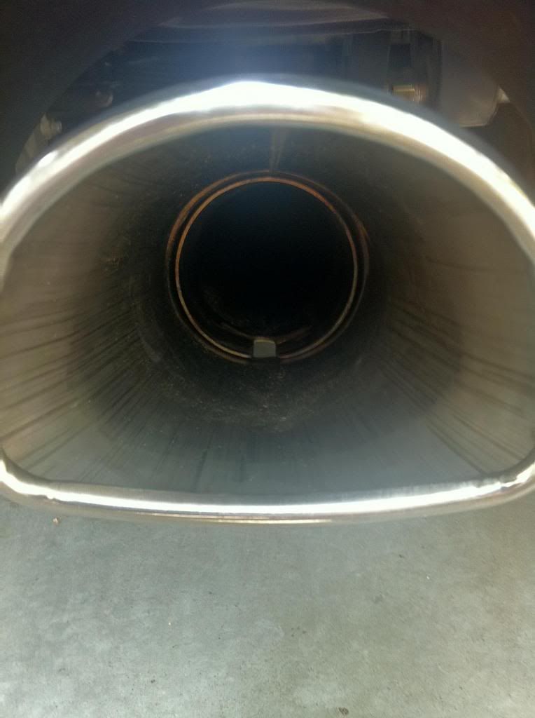

Just had the TRD exhaust installed this morning, liking it so far. Definitely a good bit louder than I expected, but it should quiet up a bit soon. Anyways, I noticed this hole where the tip is welded. Is everyone else's like this? Need some confirmation from another owner. Here's the pic:

I don't see a hole, but I notice the tab that is sticking up where the pipe and tip meet. This is just a tool to help align the pipe and tip when they are assembled. Is that what you mean?

I'm not sure, if you or someone else could take a pic that would be perfect. I can't find anything on the web yet. Is your tab exactly where my hole is? My hole is at 6 o'clock, right where you'd unbolt the stock tips. But these TRD tips are welded on.
Is your tab removable? Also, it is problem with me running like this? It doesn't look that pretty when you see it, and I paid a pretty penny for it, so would like for it to be right.

I found this install guide for the exhaust:
http://cdn.shopify.com/s/files/1/017...-18131.pdf?248
Doesn't say anything about tabs that I can see. But surely a hole going straight through the pipe right before the tips is not good, right? Trying to figure out if I should leave it as-is, or take it back to the dealer and see what they say .
I would think it would effect sound somehow too, but want some more input before I get the dealer involved.

Sorry...not a tab for installation of the exhaust, but for lining up the tip to the pipe before the welding process. It speeds up production and makes sure the tip is properly aligned. I don't have a TRD cat back, but I'm pretty confident that's what it is. Hopefully someone with a TRD system will confirm theirs is the same. If it bothers you, I would nip it off with a die grinder or dremel.
