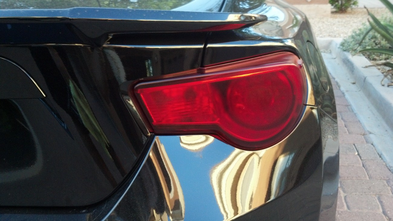

4 coats of VHT red and 4 clear coats

Edit: Finally did this! Happy with results, but still need to wet sand and polish when it is fully cured these were the products that I used:
Result:
[/QUOTE]
These came out great man!
This picture is before or after the wetsand & polish?
What did you use for the polish? I got some headlight plastic polish.. should do the trick.
Also - did you prep sand the tail light before you sprayed?
Thanks..
Attachment 47719
Attachment 47720
What clear did u use and did u do any sanding or anything before
Scoobidude is offline   Reply With Quote
Old 08-12-2013, 04:40 PM   #302
Bonks86
Drives: Gt-86
Location: AZ
Posts: 222
Thanks: 48
Thanked 72 Times in 53 Posts
I wet sanded first and I used Krylon for plastics clear coat.

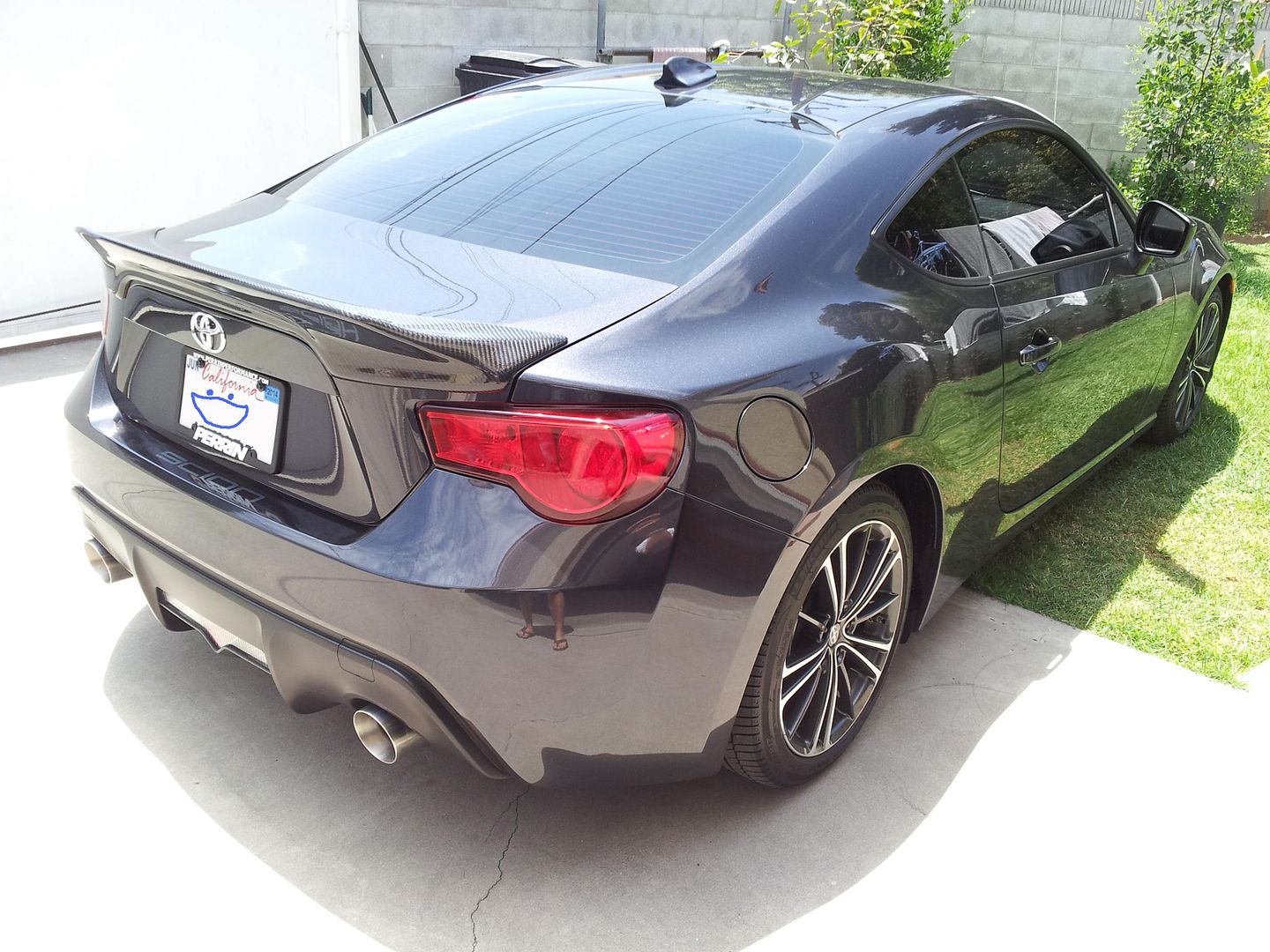

Update:
I used 2000 grit wetsand, glass cleaner (windex), then sprayed 2 coats of red with 15-20 minutes in bewteen. Then cleaned the new red coats and applied 2 clear coats with the Krylon Fusion clear coat for plastics. I also masked off the signal lights with masking tape.
I'm very happy with the results! I still like the valenti leds but this will do until I can afford those (unless someone wants to buy these of me)
Here's a quick cell phone shot:

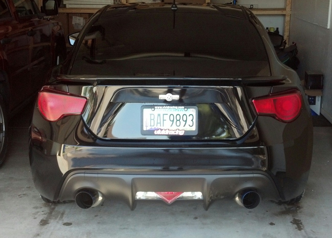

So I finished up my tail lights this morning.
I feel like I should have put a few more coats of red but I didn't want to lay it on too thick and have it start to peel. In direct sunlight they're not as deep red as I would like. They still look 1000x better though so IDC.
Paint Used
  • Duplicolor Metalcast
  • Krylon Crystal Clear Gloss
  • Meguirs Plastic Polish
Method
  • Mask surrounding area
  • Mineral spirits wipe down (with gloves)
  • I did NOT pre-sand the plastic
  • 5 red coats total (3 light & 2 heavy)These went on matte and I got scared. The clear will bring back the clarity.
  • 10-15mins in between light coats with blow dryer
  • 20-30 mins in b/w heavy coats
  • 4 coats of Clear (the last heavy coat started to run a bit but you can't really see it until get really close at the right angle)
  • The last heavy coat of clear I let sit over night.
  • 2000 grit wet sand to get out the fish eyes
  • Meguirs Quick Detailer
