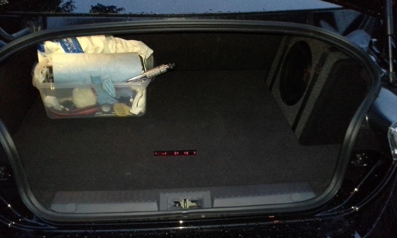

Amateur Drifter
gatorbushmen's Avatar
Drives: '13 FRS
Location: Saint Augustine
Posts: 355
Thanks: 220
Thanked 222 Times in 72 Posts
Originally Posted by Diode Dynamics View Post
1 JL W7...call it a day lol
-Nick C.
I couldn't agree more. My 10W7 is perfect, yea it takes up some space, but I can still squeeze some groceries on the side Name:  ImageUploadedByTapatalk1375207555.478729.jpg
gatorbushmen is offline   Reply With Quote
