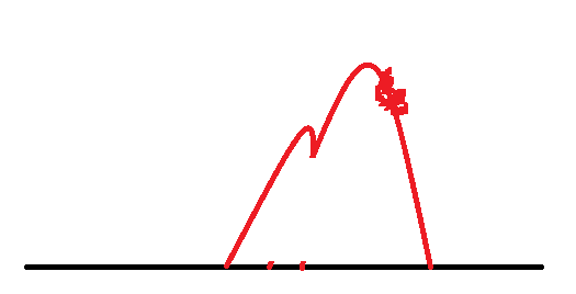

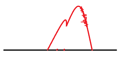

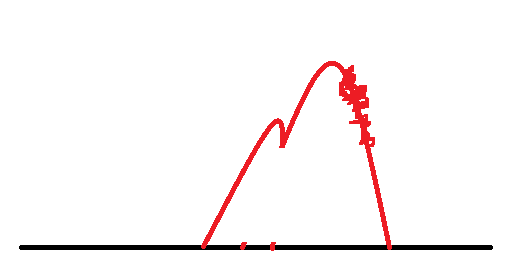

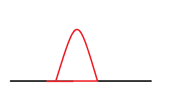

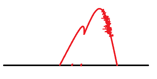

Let's look at my cartoonish representation of a typical pressure trace at high load and MBT timing (minimum spark advance for best torque). X axis is time/crank angle, Y axis is combustion chamber pressure measured by pressure transducer.
so that's MBT. Usually you have 50% burn by 6-10 degrees ATDC firing, and peak pressure (shown above) maybe 15-20 degrees ATDC. Now here's a retarded combustion phasing under full load. It's retarded because at a given rpm, we retard ignition timing with increased load to mitigate knock. In this example, peak pressure is around say 30 degrees ATDC.
All of these made different levels of power and fuel economy, and often the uglier pressure traces perform better (except for when they don't). So which one is knocking "too much" ? But why not pull timing more so the pressure trace is less noisy? Well if you decide to do that you'd lose output and heat up the exhaust, requiring you to richen the mixture to keep temps down.
Remember, the knock sensor on your car can't read cylinder pressure and it doesn't have a human being sitting there with a microphone. It's just an approximation of that process. Setting an OEM knock control system is very difficult and except for extreme cases, there is no universal consensus on how much knock is too much. It's all somebody's judgment call, magnified by production tolerances and other factors.
