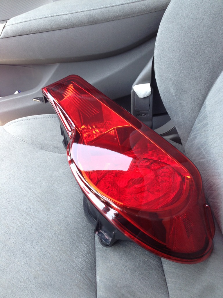

Does anybody know how to get that finish? I want them gloss looking and clear red

Make sure you wet sand and put that clear coat on or get it cleared professionally. Just look through the thread there are a few really good looking ones that are glossy.If you want to save labor im sure some shops offer it but at a higher price of course but quality would be up there.

Professional clear, good sir :happy0180:
Mine (sorry that they are attachments)
Attachment 37466
Attachment 37548
Attachment 37549
Duplicolor Metal Cast and professional clear

I just bought spray max 2k for the clear coat.
For wetsanding, is 2000 grit enough? Do I need rougher or finer?

Yes, 2000 is good. Make it look foggy and spray.

Your tails look amazing. That is the finish I would like to achieve.
Lol at the smoking finish, I don't wanna get hassled by cops everyday.
Edit: Nvm I think I've found my answer.
Here is what I'm gonna do:
1. Clean taillights
2. 2/3 layers light coats with Duplicolor metalcast
3. Wetsand with 2000 grit
4. 4-5 layers heavy clear coats with Spray max 2k
5. Wetsand with 2000 grit to remove orange peel
6. Buff it with polisher compound
7. Wax it.
Please advise.
Will these steps be better?
1. Clean taillights
2. 2 layers light coats with Duplicolor metalcast
4. 2 layers light coat with Duplicolor metalcast
6. 4-5 layers heavy clear coats with Spray max 2k
7. Wetsand with 2000 grit to remove orange peel
8. Buff it with polisher compound
9. Wax it.

The 2000 is to get the paint to stick. Just prep. You are sanding the clear lights until they look a little foggy. Make sure it is uniform and all over (even edges), then spray. The final product will be clear. When the color is done take it to a body shop. In all honesty you won't even have to color sand for it to look good (or at least mine didn't really need to be) but my shop did it anyway.

Sorry, just saw this guys. I paid $80, but he burned through the paint sanding, re-did it and once again, he burned through the paint. I offered to pay him another $60 because I could tell he was getting annoyed. This time, he let me do 100% of it at his shop and helped me as well as didn't need to sand because the paint was all fresh. I had to sand most of the old clear and red off and start over again. It was worth every penny and was still cheaper than TOM's (Only other lights I would consider)
You can probably talk a shop into doing it for around $100....Just make sure they don't sand the paint. There are so many sharp edges, it is super easy to burn through even sanding lightly.
