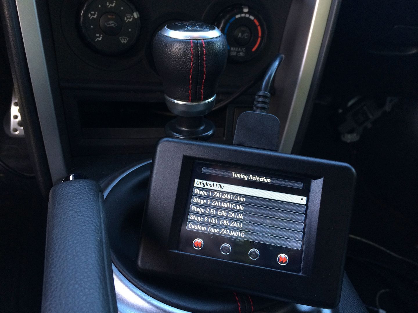

Not that it really matters, but it looks like the "Upload" section isn't pulling the correct info for FW version:
alexand3r is offline   Reply With Quote
