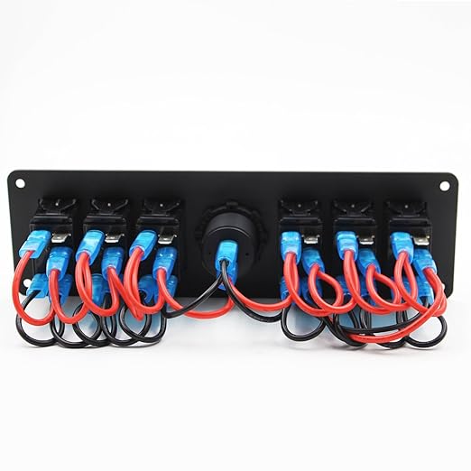

I'm working on some projects, and want to consolidate my wiring. I've already built a switch panel, and the above is what I am looking to put into my engine bay. My switch panel has four switches. Each one would trigger a different relay. The item linked above is neat because it can house all four relays (it can hold six, but I only need four) along with the four fuses I would also want installed.
However, I have two issues with the above item. First, it's crazy cheap, which has me worried about quality. I wouldn't mind something a bit more... quality... and better resistant to moisture and whatnot. Second, and more importantly, it's basically just a plastic chassis, but there is no common rail for me to feed power in and out, meaning I'd still have to merge a bunch of wires together underneath, where all the pins come out.
So my question: Does anyone know of a product similar to this one, that could house four relays and fuses, but perhaps a bit higher quality that includes common points for power and ground to keep the wiring simpler and neater?
