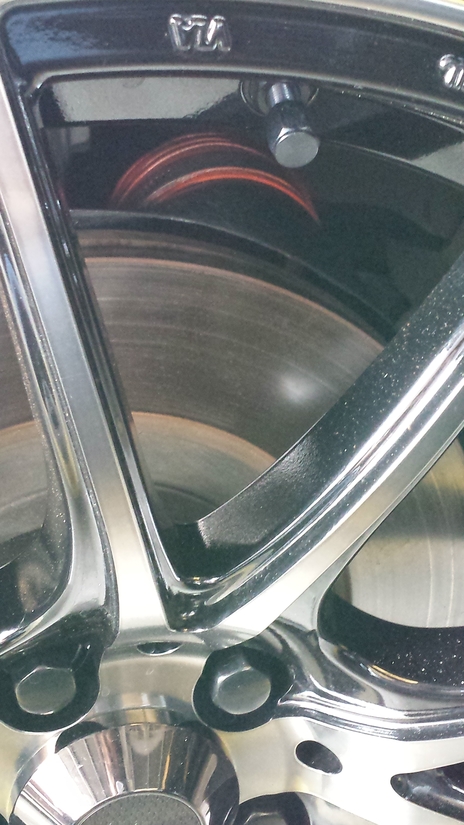

Car Background
So the car came with a set of Rota Roku flat black 18x8.5 squared with GT Champiro SX2 235x40 tires. I kept them but I removed them from the car planning to dedicate it for track use only. As a result, I got 2 more wheelset for the following purpose:
1.) Daily driving - Wedssport 18x8.5

After using all three wheels for street, drifting and track, I came to the following conclusions.
1.) Square set up for daily driving seems to be the most practical. I used the old set of tires on the rotas and placed them on the wedssport and I am happy with these tires. But I am wondering if 235 is unnecessary for daily driving and that perhaps I should go for 225 for practical financial reasons when the time comes to replace the tires which may have to be next year. Thoughts on this? Note that the wedssport is 8.5 width.

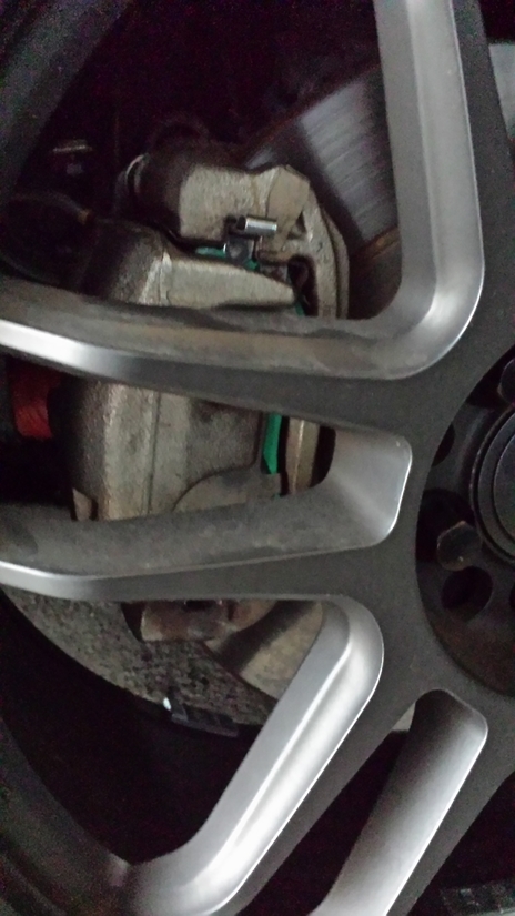

Since I plan to continue using this in the track hopefully at least a few times a year, I have done the following brake upgrades:
1.) Project Mu HC+ 800 pads with stoptech steel lines and motul high temp brake fluid

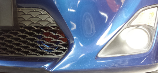

2.) APR Brake Ducts w/o the inlet. Installer came up with their own inlet

So far I was only able to do each run session for no more than 5 laps at a time since I did not have an oil cooler yet. Hence I did not experience any brake fade despite having stock calipers of 2 pot and 1 pot and stock rotors.
With regards to the APR brake ducts, I did not follow their instruction that instructs you to cut through the fender lines. I did not want to cut a big hole along the fender line since I was concerned that too much dirt might get splashed into the engine bay when driving through a puddle or driving on a rainy day. The installer was able to route it through an existing hole below the fender line. I also did not want to remove the existing fog lamps that came with the car hence the reroute and customized inlet on the sides of the bumper grill. The installer tested their routing by using a fan blowing into the inlet and it worked fine and my experience in the track was so far alright.
