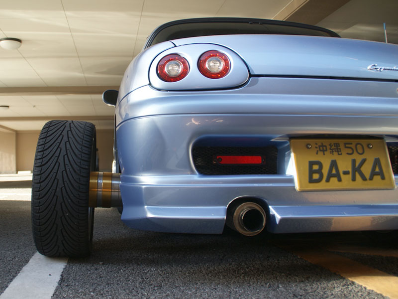

Sure you can

Originally Posted by NyC Zn6 View Post
Sure you can
Attachment 143021
Holly Shit. I'm pretty sure that's unsafe!
