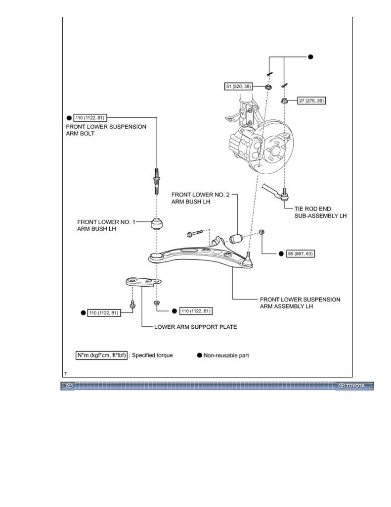

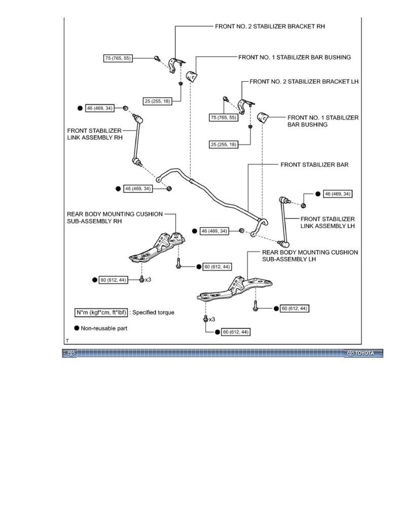

Front suspension torque specs and diagrams from service manual.
Thanks to azian_advanced for posting the entire service manual.
